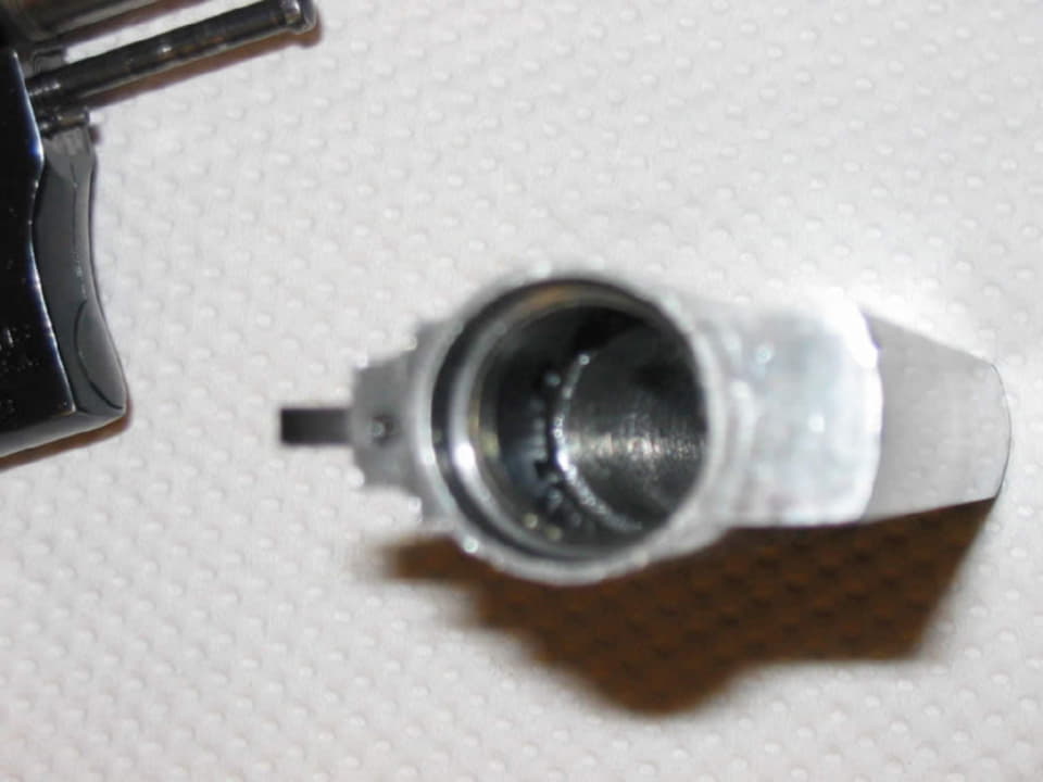

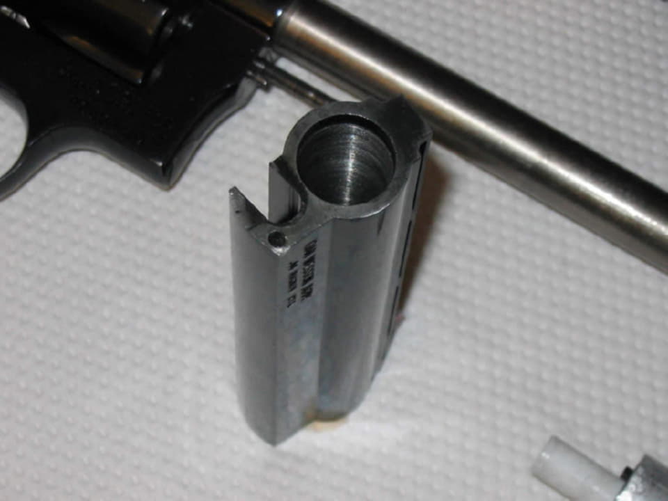

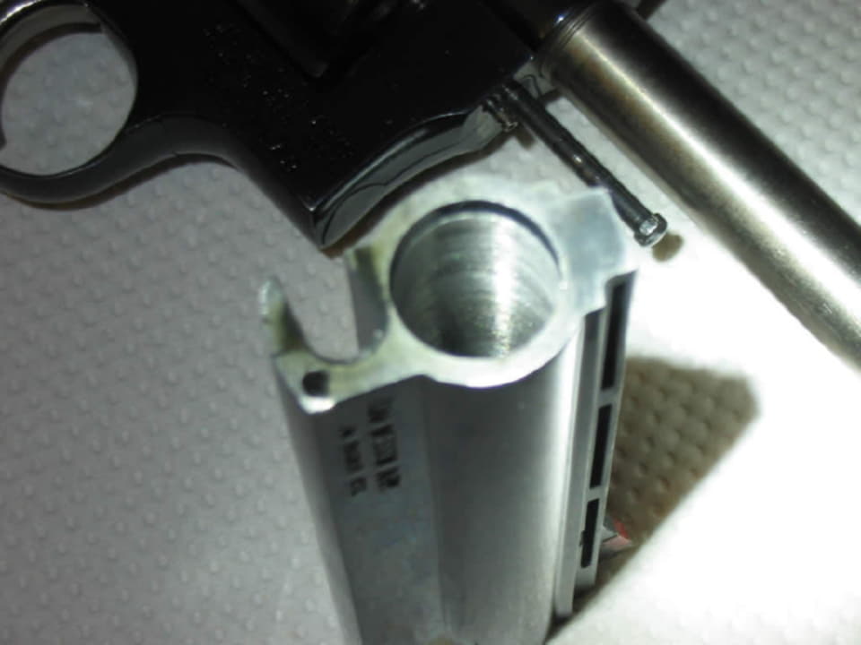

March 25, 2010 - 11:23 pm
Here's some pictures, and yeap the shroud is completely threaded from the cylinder end up to the ported section.
Sorry the pictures aren't better but close-up shots are a PIA.
So any ideas as to why it's threaded so?
March 26, 2010 - 7:52 am
I am betting someone forced a barrel through it the wrong way. It looks about like the one I messed up a few years back in a stupid fit of stubbornness. The good news is the shroud is fine, attach a strip of sandpaper to a dowel, put it in a drill and polish the inside of the shroud until the barrel slides in and out without resistance. As for the barrel threads you will need to see a smith for that one, but since you have another barrel you are good to go for now at least. Let us know how she comes out if you decide to do what I did.GoodLuck
