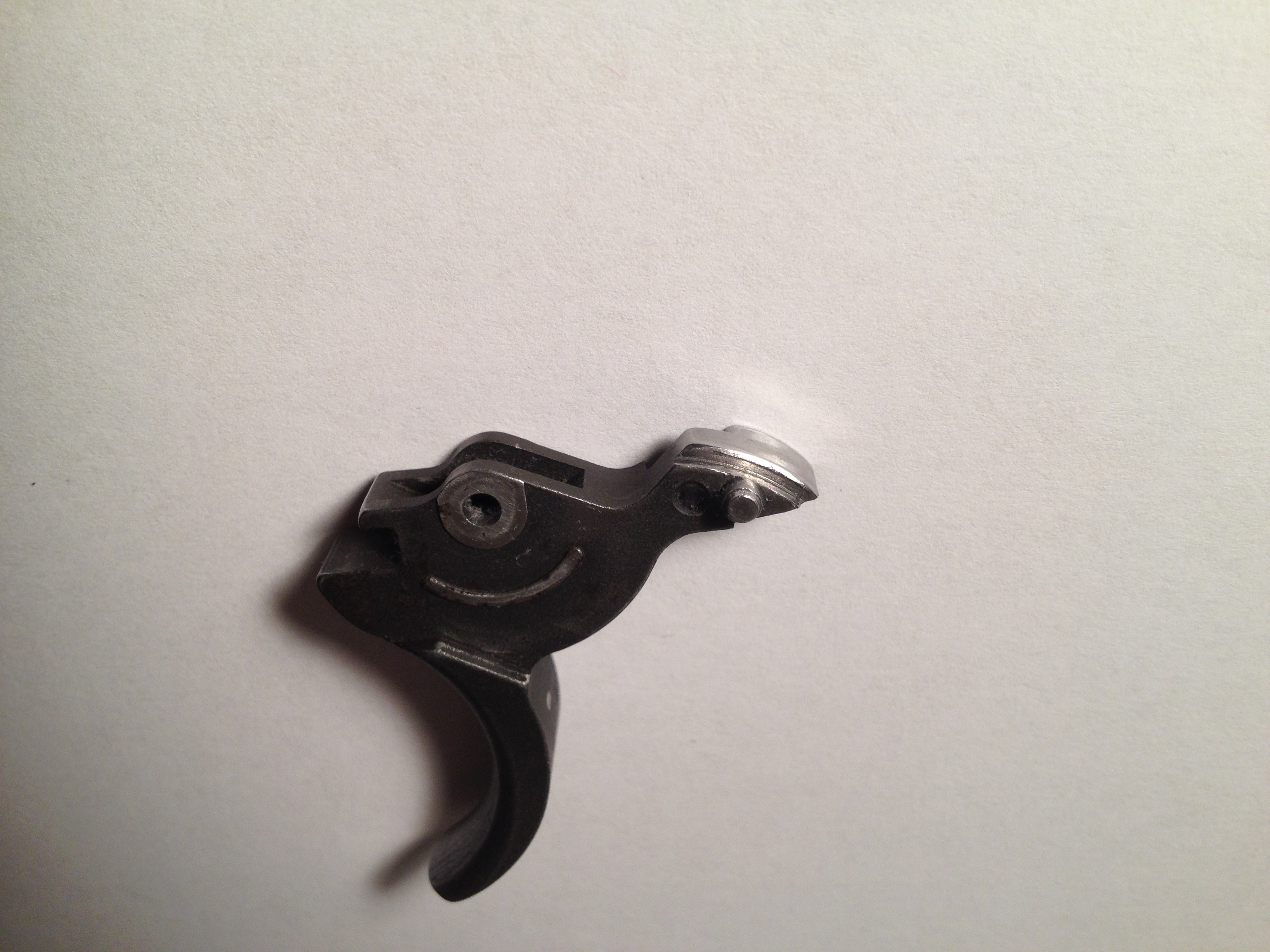

I'm sure the short arm of the spring is in the correct position (care during installation and the long arm has considerable force).  I tried to include photos in a post on this subject on Sunday, but nothing went through.  I'll try to post pictures separately.

May 1, 2015 - 10:00 pm
011.JPGImage Enlarger
Rear-of-trigger.JPGImage Enlarger
001.JPGImage Enlarger
The second photo does appear to me to have a "shelf" where the return spring rests that has been ground down below the post that the hand fits onto and none of my triggers look like that.  I am relatively new to this so get a 2nd opinion, but if that shelf is below the post I do think that is your problem and might be best to get a new trigger.

Forum Posts: 5437
May 3, 2015 - 6:23 pm
It doesn't look bad to me.  It may be a bit worn.  Try some light file action.  Notice the shelf falls back to center a bit. Yours may be tailing away towards the outside.
DSC01488.JPGImage Enlarger
DSC01487.JPGImage Enlarger

May 4, 2015 - 9:51 pm
PAbowhunter and SOWELA,
After reading your posts and seeing your photos, I think the rearmost portion of my trigger is definitely out of spec.  Compared to DSCO1488 my trigger is missing a lot of material.  The point of my shelf angles down and toward the hand.  I'll try recreating a squared and pocketed point.  If no success, time for a new trigger.

May 6, 2015 - 9:54 am
IMG_0484.JPGImage Enlarger
IMG_0485.JPGImage Enlarger
IMG_0500.JPGImage Enlarger
Here are two trigger hopefully you can see the amount of material/metal between the post that holds the hand and the shelf that allows the trigger return spring to ride/slide along.

May 6, 2015 - 5:21 pm
No more sticky trigger.
I widened the shelf and created the concave I see in the photos.  I used small files and a stone.
That's what it needed.  No malfunctions after more than 200 dry fires (boy my hand was tired), 30 rounds of 38 Spl, and 20 rounds of mags (boy my face was smiling).  This revolver rocks.
