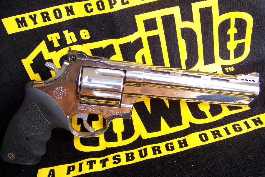

Here is a stainless polish project I am working on right now:
I've tried a variety of techniques, including Mothers, this is the result of some work with a polishing wheel and polishing compound, which is not a finished product.

Hmmm... Am I wrong or were you wanting to polish a stainless steel to a nickel
like finish....heres a polished stainless thats as almost chrome.
This is exacly what I ment, sorry for the confusion. I want to polish my stainless steel revolver to a mirror finish. Just wanted to know the pros and cons of it.
