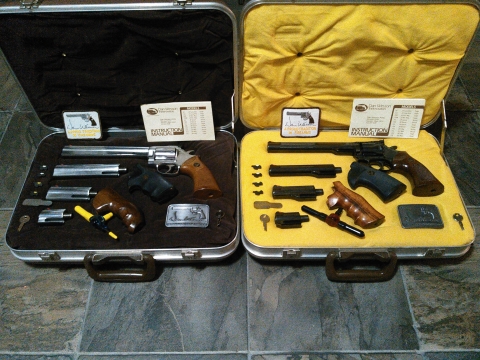

Without taking my grips off can I get an educated guess in my stuff is round or square tang, I dont know for a fact if all the grips pictured even really went with the pac's originally

September 13, 2018 - 5:20 pm
 Square tang is Small frame and Round tang is Large frame.

September 13, 2018 - 5:37 pm
Square tang = .357 and smaller
round tang = .44  up and any SuperMags
Removing and changing the grips is very easy don't be scared.

September 13, 2018 - 9:36 pm
That was easy, kinda make me feel stupid.
Changing grips is easy enough, do know not to get the screw too tight.

September 14, 2018 - 11:43 pm
Yes, not too tight on EVERYTHING on a Dan Wesson revolver; barrel nut, grip screw, side plate screws. Wrist tight is enough; once you bring your elbow into it you're likely to cause some damage. I speak from hard earned experience.
September 16, 2018 - 7:46 am
The rubber grips, one Gripper and one Presentation, are aftermarket. The finger groove grip with the blue gun appears to be a Hogue, not factory. The black cloth is not original. The buckles and patches may be date appropriate or may not be depending on the serial numbers. They are factory though..

September 16, 2018 - 9:51 am
The presentation came with the pac and the gripper was bought off E-bay from lonwolf.
The pac case with the black cloth is incorrect however, Dan Fan thinks Joann fabrics has something very close to original....I kinda like the way the chocolate colored cloth looks with the SS however I am going to get that fixed.
