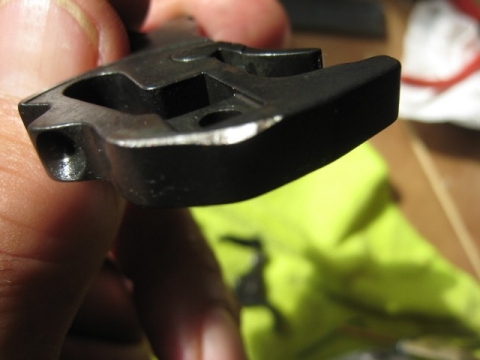

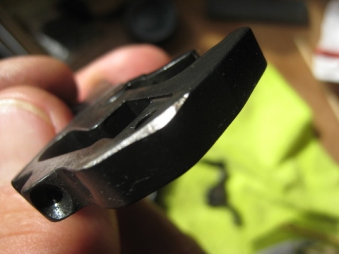

The gun is a '81 15-2 I recently bought. SA is fine. DA the hammer travels back normally until just before or usually just after the cylinder locks up. It then stops and requires much pressure to get past that point. This happens when trigger is pulled slowly DA. I'm not talking about "stacking".IMG_0308.JPGImage Enlarger
IMG_0306-1.JPGImage Enlarger
IMG_0313-2_LI-1.jpgImage Enlarger
If I pull the trigger more quickly it's not usually noticeable. It happens with the cylinder open or closed. I removed the grip screw and it made no difference. I took the gun apart to give it a deep cleaning and saw the bottom right edge of the hammer is worn and gouged apparently from rubbing the frame. This edge is not smooth but uneven as you may be able to see from the photos. There's a photo of where on the frame I think it's rubbing. I have to wonder what is allowing the hammer to be in a position to rub that edge? Maybe wear on the pin the hammer pivots on allows it to lean enough to rub? In that case possibly a shim at the base of the pin may help?  It doesn't seem to be a normal wear point to a untrained eye. It shoots great SA but I'd like to get the DA right if possible.

I don't believe that is the problem with the hard/ inconsistent trigger pull since the part of the trigger that shows wear is against the frame with nothing riding on it.  A PO may have thought some filing would smooth things out- not certain.  My bet would be spring related- maybe the mainspring...

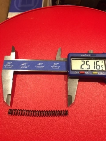

The spring should have tight coils on each end and be about 2.5" long.  If it's not, there's a chance a PO may have cut it in an attempt to lighten the trigger pull...

You were correct, sir. I finally just isolated the problem being the trigger return spring which the previous owner had installed. I bent the end of the trigger return spring slightly where it rides on the "ledge" of the trigger and it corrected the issue. Occasionally the trigger wouldn't return even after adjusting the over travel screw. It took a little trial and error but it's much better than it was and the problem has been isolated. It seems a whisker one way or the other makes a big difference. It was frustrating since the internals are so simple but in the end I remembered what you said about it being spring related. Thanks.
