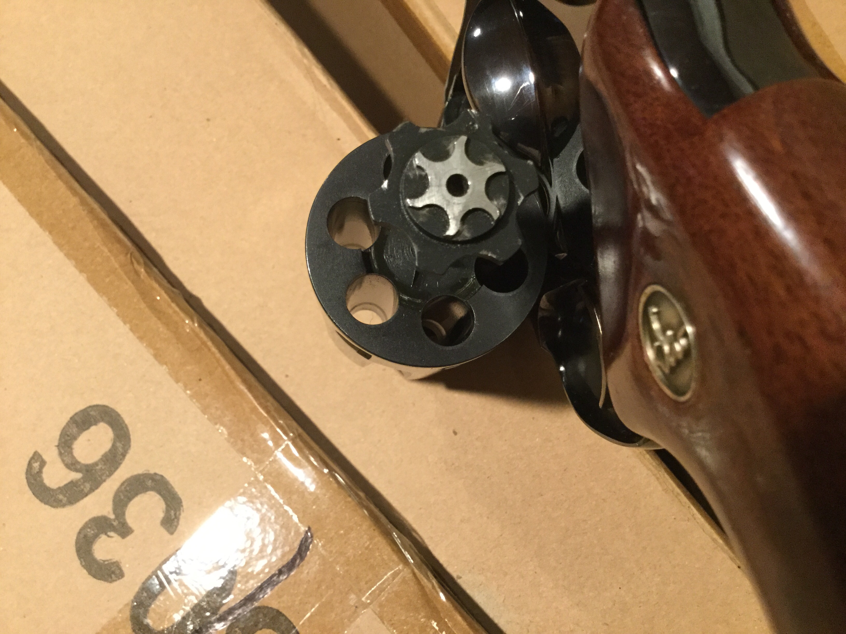

So I have a new to me model 40 and I was looking at the cylinders while trying to figure out why (while figuring out reloading stuff)  my 180gr xtps (.357) would slide through the cylinders but the 200gr ftx (.358) bullets would get "hung up" in the barrel ed of the cylinders and I found this:

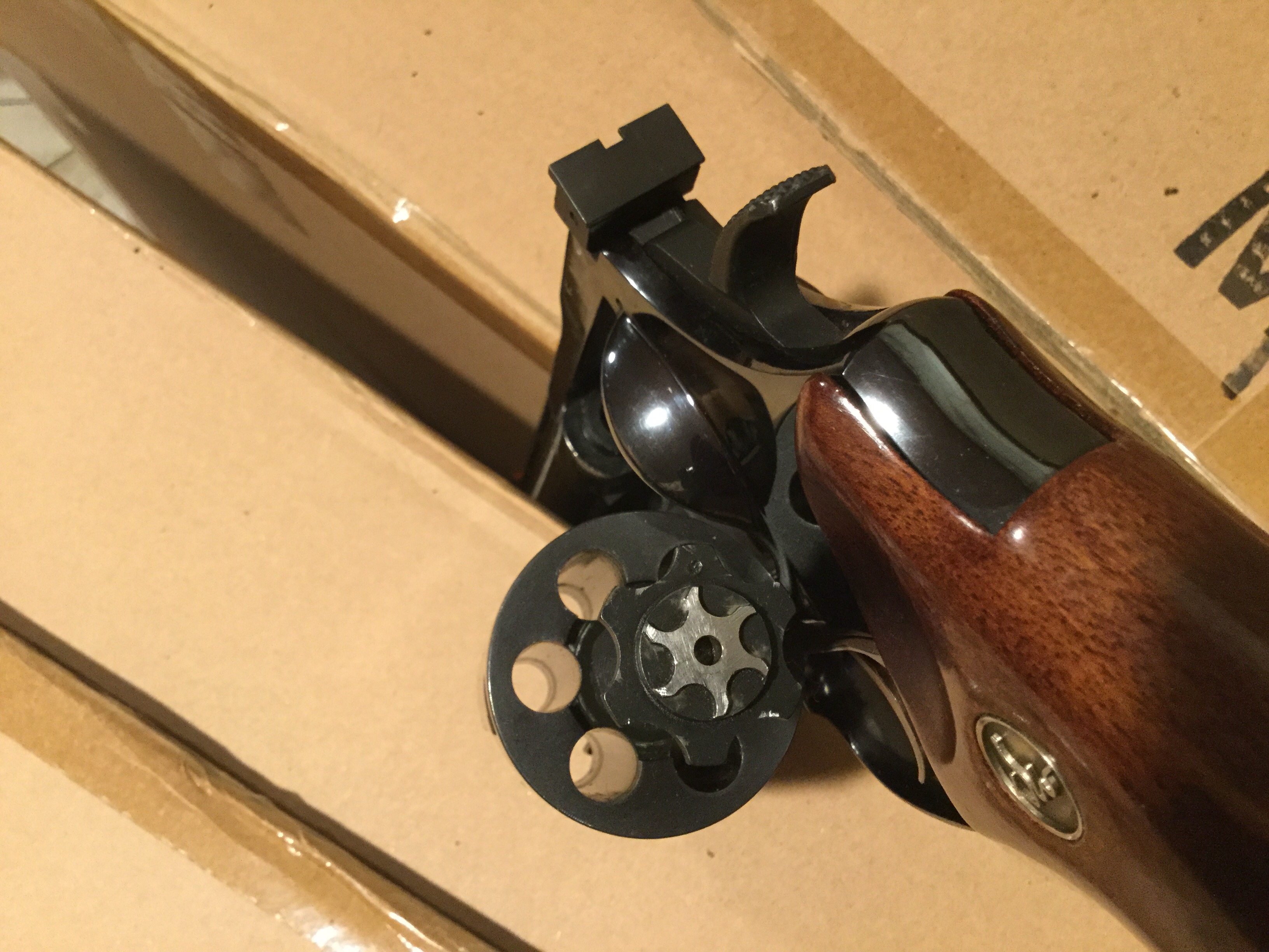

Is is little "lip" in the cylinder normal?
And I didn't get a barrel gap tool with this one.  Might anyone know of the proper gap for this ?   and since I'm already picking everyone's brain, what is the gap for a 44 mag one?  Is it the same as for a model 40 or for the 15-2?   All answers greatly appreciated.

Most revolvers have a lip like that at the front of the cylinder to help align the bullet to the bore.

Thanks for letting me know. I don't think I'd ever have noticed it if I wasn't looking.
January 21, 2017 - 8:52 pm
Chamber throats, totally normal, helps align bullet with forcing cone of barrel.
BC gap should be between .002"-.006" on the tightest chamber.  I run most of my supermags at .003, reduces flash and flame cutting and keeps velocities highest.
