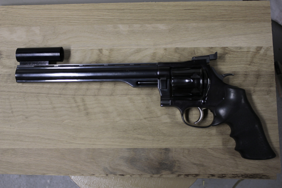

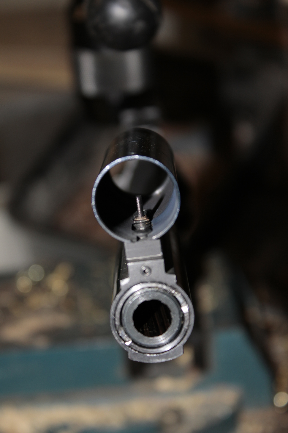

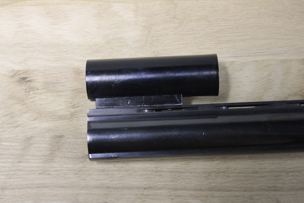

Hi...
I installed to my DW 44 magnum Finn Sight rear and front sights, they are similar to bomar sights.
Ville
May 30, 2015 - 6:43 pm
Very interesting looking sights. The website does not really provide much information, did it require any modification? Pictures of your gun would be great to see.
devlon
South Ostrobothnia, Finland
Forum Posts: 9
May 28, 2014
July 2, 2015 - 6:34 am
Hi...
Rear sight is are Ruger sights but can drop in style maybe slight filing to fitting, both Ruger and Dan Wesson uses Eliasson sights.
Front sight is slightly tricky because its base is machined from aluminum and mounted with screws, my friend installed my front sight with two screws first one he made block what fit in original sight place and screw it in that block and second srew he put in sight rail.
