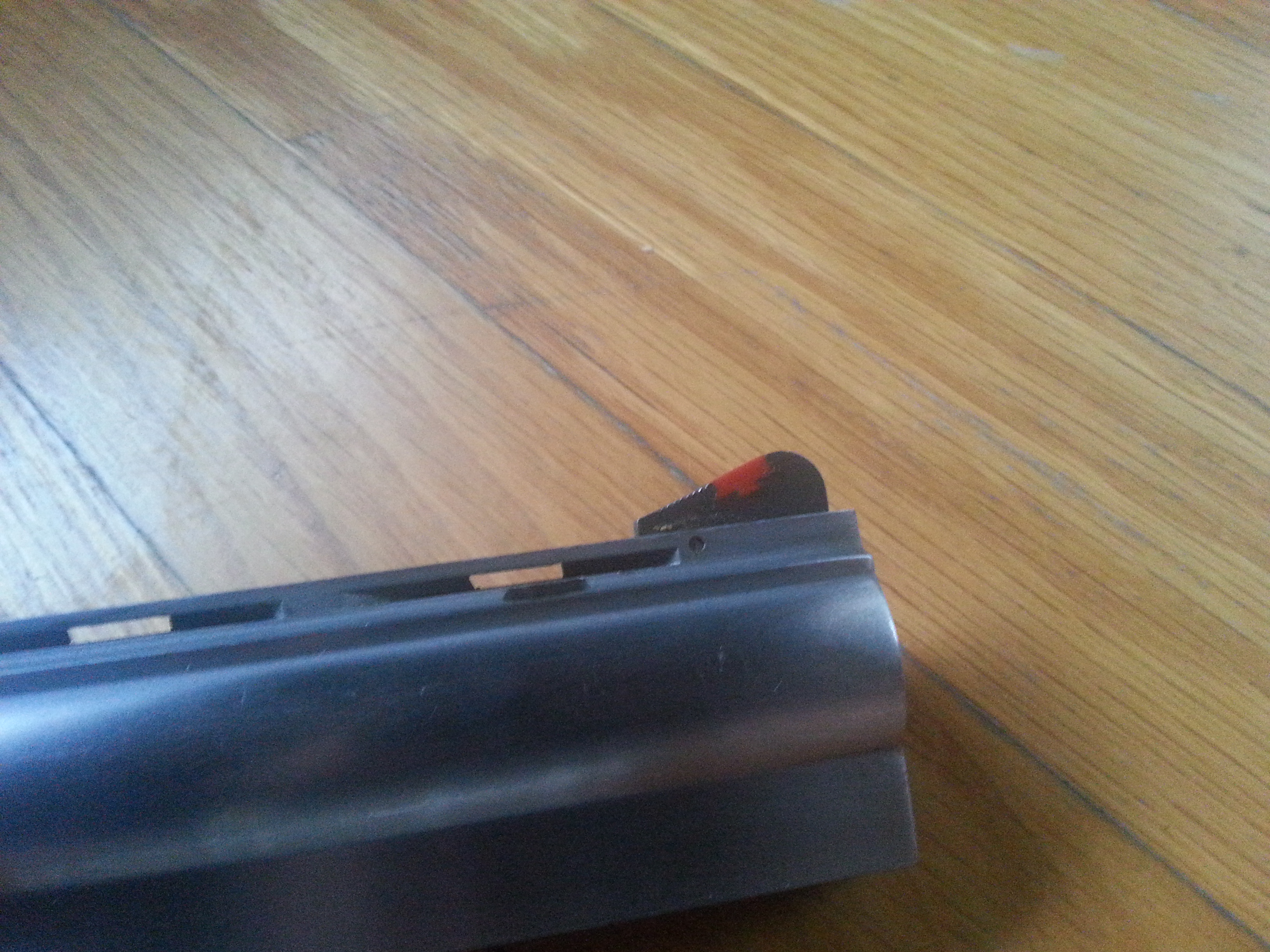

You say front sight is quite tall. I ask what sight is on barrel? Is it the ramp sight that came on barrel?  when you say benched I assume you men clamped in a bench.  Problem I have there is the gun should shoot in the direction you point it clamped down. Personally, I think you should shoot from sand bags, resting your wrists on the bags and not allowing gun to rest. Be sure you are holding the grip with same pressure and placement on each round. That is an awful high throwing, IMO, for only 1400fps.  Just me..  What does the bore look like? Have you had the shroud and barrel off?  Let us know these things.

The front sight on both barrel shrouds measures approximately 5/16 to the crest and just about 1/4 of an inch to the highest part of the orange insert.
At this point it seems like the barrel and shroud must be shimmed up at an angle! I don't see any evidence of that, but I'm feeling a bit at a loss. Especially because it performs the same with the both the iron sights and the scope mounted on the shroud.

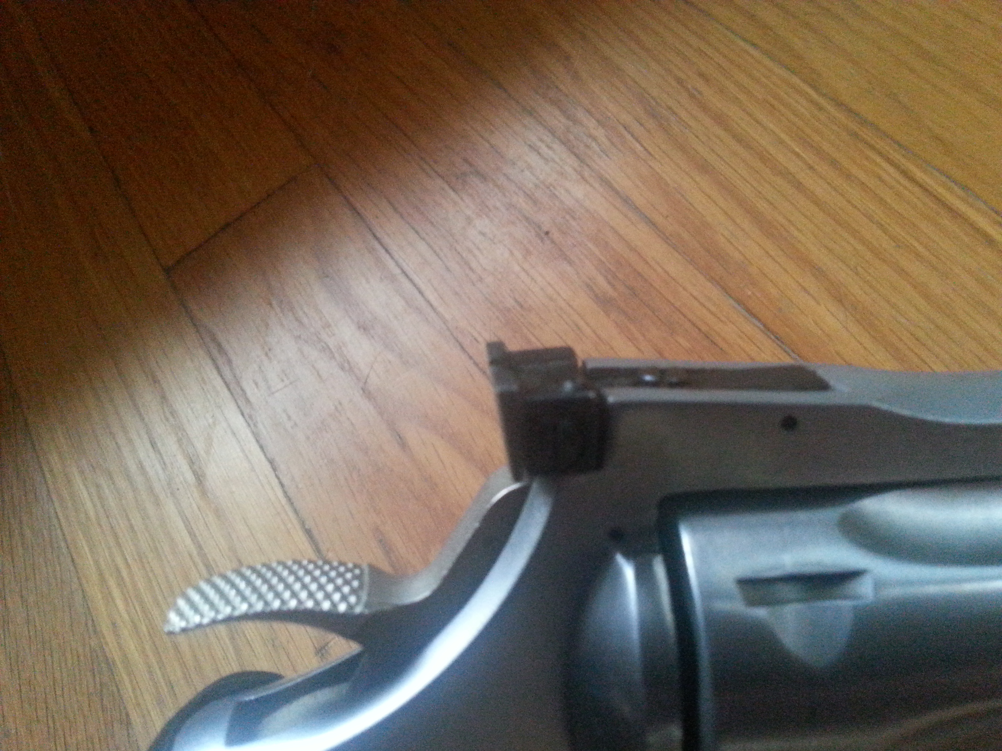

Looking at your gun picture, your rear sight is bent down from the mounting tang...that part that attaches the rear sight to the frame. I had one that someone also dropped before I got it that looked the same. The rear sight is bottoming out in the frame notch. You can remove the sight, bend the tang back up and reinstall the sight. That will allow the sight to be lowered some more.

Now that you point it out, I compared my rear sight to other photos and it does look as though it is bent a bit and not seating perfectly in the frame. It feels solid right now, so I'm not going to mess with it until after I get a look at the barrel. My feeling is that I might loosen it with more bending and, while it may be a contributing factor, I don't think the drop I gain will make up for a 6 inch rise in bullet flight in the 15 meters between 10 and 25! : ) Did it make that much difference in yours?

that pic of the close up sight looks like it is screwed down to the bottom... may be wrong

The rear sight is screwed down all the way, and yes, the springs are underneath it. Even if I removed the springs, I don't think I could get it to go any lower. The bend, if it is accidental and not original, just changed the angle of the sight block right at the metal arm so that it doesn't match the cut-out in the frame like some other pictures show on other similar Dan Wesson revolvers. Again, I don't have anything to compare it to before/after or comparison to another pistol like it.

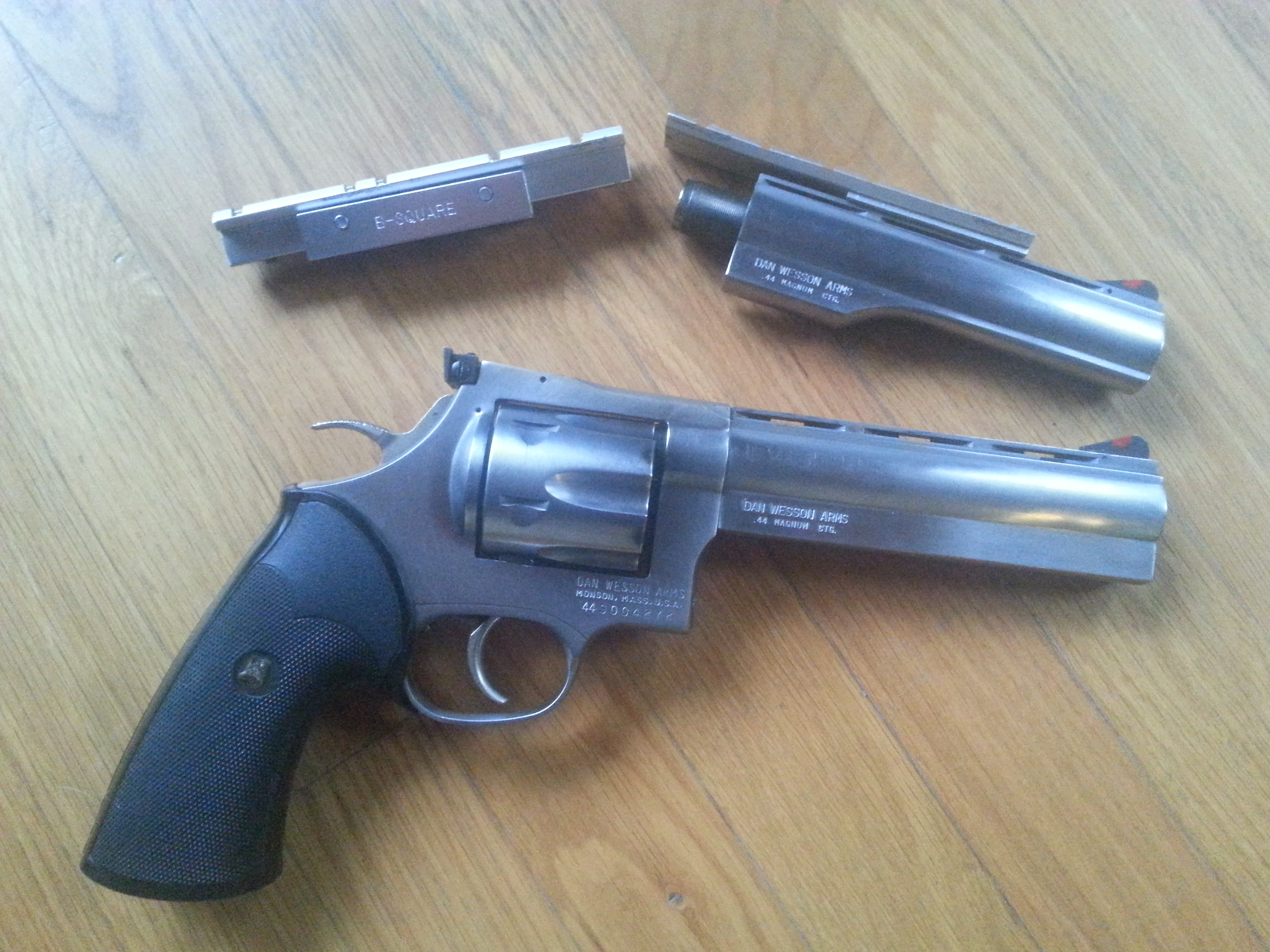

The wrench arrived right in time from EWKarms today. I'm almost sad to report that while there was some build up in both barrel nuts it wasn't anything substantial.
I rolled both barrels across a flat surface and they seem perfect. No wobble, and with a light behind them there is a consistent sliver of light underneath them add they roll; a little light at the frame end tapering down to no light at the nut end.
I set the cylinder gap at .003 and it is fine for three, but the other three are tighter at the to of the barrel/cylinder gap than they are at the bottom.
I put the second barrel (I have not yet tried this one) in the shroud I already tried and put it on the gun to test tomorrow.
Thanks again for your suggestions.
