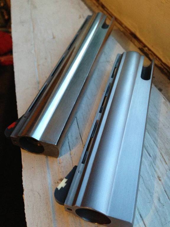

I took everyones advice and picked up some scotch-brite pads. I worked on the 6" shroud first to see what kind of results I could get. There are a bunch of dings that are too deep to sand out. I guess I'll just have to live with those. One of these days I'll get some decent light to take pictures in, but this will work for now.
Original finished as received on the left, and new satin finish on the right.

Nice job I think! To me, the one on the left looks as though somebody polished it at one time. The one you did looks like a factory Dan Wesson finish.

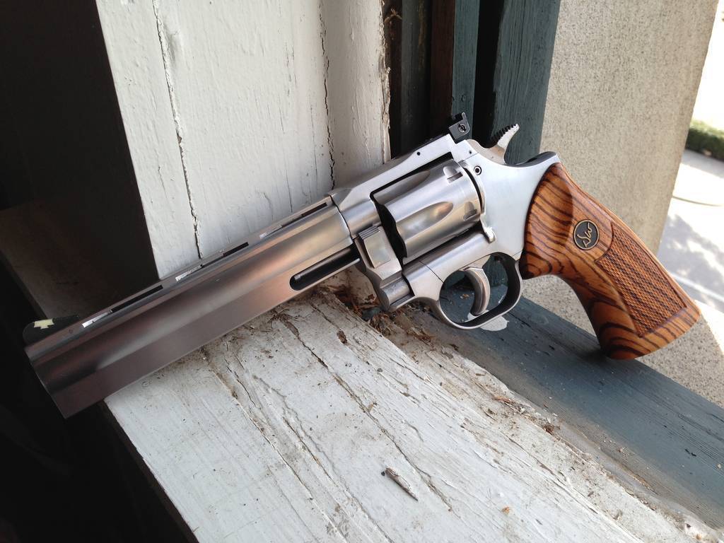

Well, I'm making progress. Fixing the frame is a lot tougher to get right than the shrouds. At some point in the future I'll have a professional redo this one, but for now this will work. The gun certainly looks better in the pictures than it does in person.

Nice work cleaning her up! Certainly looks good from pictures and the grip really sets her off!
