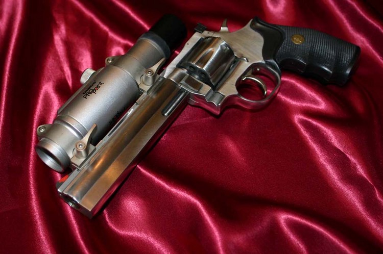

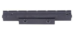

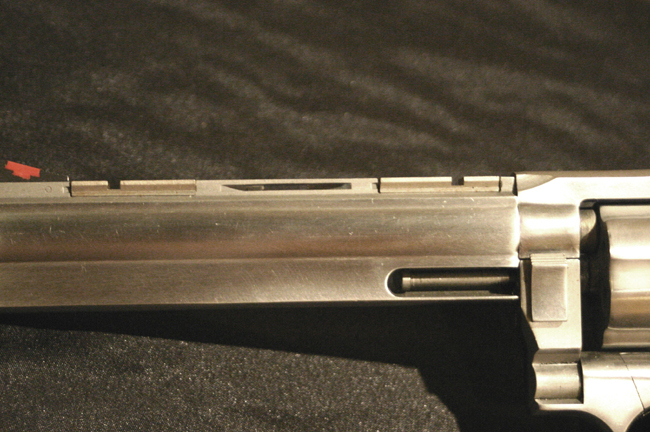

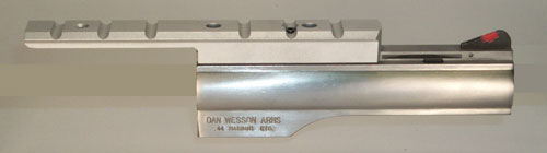

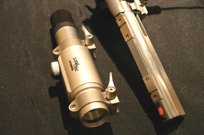

July 27, 2008 - 5:26 am
The pics below are from a posting on The High Road concerning different mounting options for Dan Wesson Revolvers.  Here is a link to that posting.
I thought this option looked really interesting.  I might pick up an extra shroud from DW to try this on.  Below are pictures of the other options...
460smdave
Forum Posts: 140
July 28, 2008 - 10:14 pm
Very cleaver way to mount the scope. The only problem I see is the further forward the mounts are the closer the gun has to get to my face when I shoot. Might be nice on the smaller guns but not sure about the SM.
