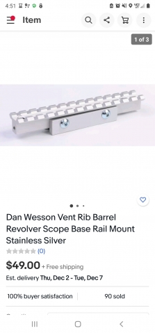

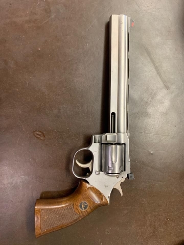

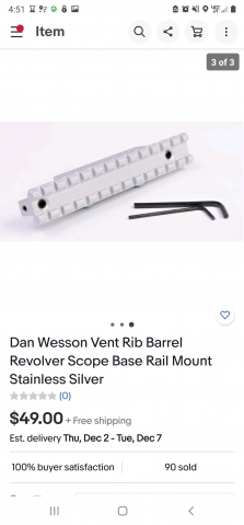

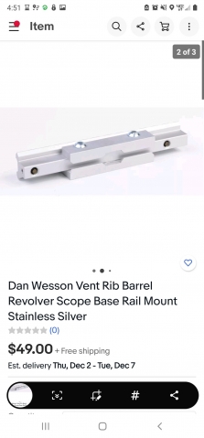

I have a model 715 in 357 magnum that I want to deer hunt with.  I've come across these mounts and wanted your opinions on it. Also include a pic of the new to me pistol.
November 26, 2021 - 7:24 pm
Very nice gun. Any of the clamp on mounts will mar the shroud. I would recommend a D&T mount but then you have holes in the shroud. They are more stable though. My solution is to obtain another shroud with perhaps cosmetic issues to use with the scope. I would use a standard shroud D&T or a vent shroud. The added weight of a mount and scope would be less than using a VH shroud. It doesn't have to be stainless either. The deer won't care and who will see you in the woods besides your Buds? Besides, Taurus Raging Hunter's have black shrouds and stainless frames. It is in style.

Funny you started this thread. I just bought one of these scope mounts a few days ago. Won’t be here until Tuesday. My other 3 DW’s all have the DW drill n tap mount but figured I’d see how these ones on eBay work.

Stupid question but I wonder if you put some painters tape or something underneath the clamp to minimize marring?
November 27, 2021 - 8:47 am
Worth a try!! Or liquid plastic. Do they still make that?
Forum Posts: 1238
November 27, 2021 - 9:38 am
I put painters tape on the backside of my Aimtech grip mounts on my 52-2 and High Standard. It has worked well so far.

Good to hear! I know y’all will hate me and cringe at the thought of it.  BUT I’m tempted to slap a scope on my newly acquired 15" barrel…😬
Will definitely use painters tape. I think there shouldn’t be much movement with the scope base (which would most likely mar the shroud) under recoil because of how massive and heavy the barrel is.
Forum Posts: 1238
November 27, 2021 - 10:35 am
Tape it to the mount side to alleviate any chance of the adhesive staining the finish.

Clamp on mounts also have a tendency to gouge the edges of the vent as well...
