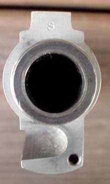

I noticed something this morning that I had not seen before.  I was cruising GB and spotted this picture.  The picture is of a DW 744 shroud.  I noticed the "S" stamped in the shroud I would assume it means "Stainless".
I checked my 744 shrouds and its on them but not on my 357 Blued shrouds or my 722 shrouds.
Just thought it was bit of info worth sharing.

I checked my 741 and found a different detail: my frame and shrouds have two locating pins!
The first is in the usual location, the second is right where the "S" is on Jody's shroud picture.  I don't see any "S" identifiers on my shrouds.

I just pulled the brushed blue shroud off and its stamped "C" which I assume stands for Carbon.

Some of my SS shrouds marked “S”, some not.  Haven't checked the blue ones yet

The S on the shroud was for Satinless so when we went to polish them we could be sure that we were polishing one for a Stainless gun, as for the Blued they had a C on them for Carbon .for the blued guns
Forum Posts: 11284
May 2, 2009 - 6:41 pm
That makes sense. After they are polished, it would be hard to tell them apart before the steel ones were blued.

Now the question is when did they start doing this?  My Norwich shrouds has the S and C but not the Monson era guns.  So can one safely assume this started once they moved to Norwich under Bob Serva?  Anyone have a Palmer gun they can check for us?

I do believe it was started by Bob so that we could tell the difference when we were polishing,

That makes sense.  All of the shrouds probably look the same before they are blued.  Good manufacturing line thinking to prevent mix ups, etc.
