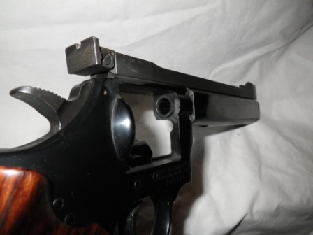

Many years ago, I picked up this unique Dan Wesson .357 Mag with slabside 6" barrel and a Bo-mar Centerhold sight.
Its a duzzie of a heavy gun - great for plinking.  I just had it serviced/cleaned by a local gunsmith and I was trying to find more info on it.  I was hoping that you guys/gals might have some answers.

Wow, interesting gun.  It almost looks like a PPC barrel with the bottom piece missing, except I think all of the PPC's were stainless. Are there threaded holes in the bottom of the shroud?

Firstly, thats one heck of an interesting looking DW. By the picture it very much appears to be a 15-2 aka the small frame. Houge makes rubber grips for it, they can be found easy enough on ebay and gunbroker(aka GB). Swapping between it and the grip is just one screw, very easy/quick process.  BTW I strongly suspect the grip you have is in fact a Houge already, and a nice one at that.
As a 15-2, the barrel/shroud should be interchangable as any 15-2 (unless it is a fixed barrel, which is not common). However, I am uncertain about how that top rail is attached so I am not sure if it is as simple it would be with a standard 15-2. Do you have the barrel removal tool and feeler gauge? if you can remove the barrel, then you can replace it.  BA's can be bought from gunbroker, from CZ, or from our own custom barrel maker EWK ( see link to the right).

Welcometo the DWF Sign. The others answered most of your questions. However I will add and ask of the rest of the gang. This does look like a PPC model with the counterweight removed. I believe that is called an aristocrat sight. I believe I recall seeing a blue version. There are pictures of an PPC somewhere here in DWF land. Either way it's really cool and I am looking forward to hearing more about it as well.

I will attempt to get more pics, specially of the PPC barrel.  If memory serves me correctly, for some reason when it was blue'd, a logo was etched in the barrel, but the blue-ing process caused it to go blurry...it might have said Dan Wesson Arms...but more pics to follow.
I did see the PPC barrels pics on this site.  Similar yes, but like some of you stated, mine is blue'd and it does not extend pass the ejector rod (a pic will  better explain this).

here you go!
November 15, 2010 - 9:48 pm
Is there are barrel nut in there ? ? ?  Your grips pretty cool...wanna sell it ?

Based on some of the pics I have noticed on this site...it appears that this is not a barrel that is interchangeable.  Thus - no barrel nut.  The more I think about it - you will need to remove the bo-mar sight so that you can have access to the 6" barrel.

Definitely an interesting gun.  That muzzle looks strange. I would like a closer look. It looks almost rough around the barrel.. really I can't tell what I am seeing. From what you said, do you think that removing the sight either from above or below that the muzzle end would be affect.. ie the barrel nut un-covered?
November 16, 2010 - 12:41 am
To me, that looks like a custom barrel. I have seen similar barrels on S&W and an occasional Ruger. I found this pic just now & the info with it says that it was built by Jim Strahan, for PPC shooting.
Yours is the first DW I've seen with a barrel like that, I like it!Laugh

Here's another custom S&W barrel similar to yours, made by Clark Custom.

The first pic by Chargerfan is very similar to mine.  Most likely, this is a custom DW used for PPC leagues.

That is just like the old "Smolts"... Colt gun with a S&W barrel or vice versa.  That looks like an aristocrat sight rail.
November 19, 2010 - 7:12 pm
To me it looks as if the nut was filled, I would explore it some what and see if it hasn't been turned down or filled in.  Nice looking Dan.
