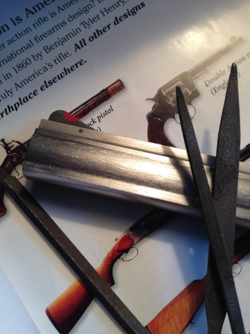

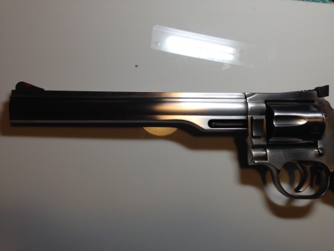

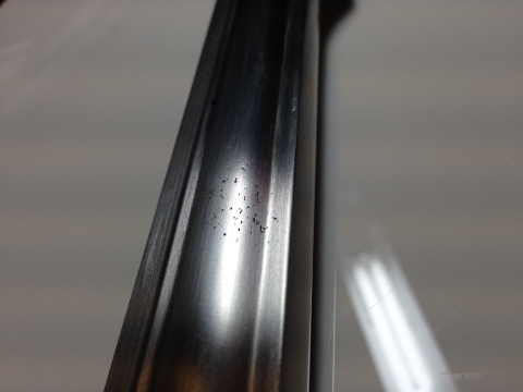

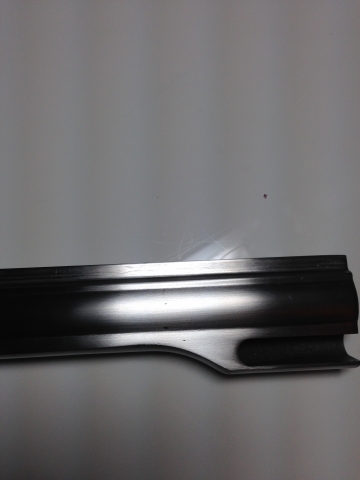

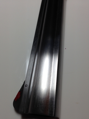

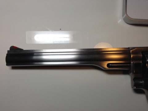

Just picked up this clean Monson 715, but It came with a damaged unvented 8" shroud showing some deep pitting in two areas that had been sanded down but with disastrous results, leaving the surface still pitted but now wavy as well. Really unsightly. Someone suggested a local micro welding outfit that will charge me $150+ to fill in the spots but  the resurfacing is still left up to me, so I did it myself the hard way.

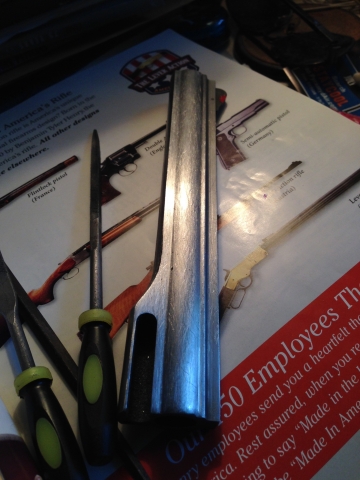

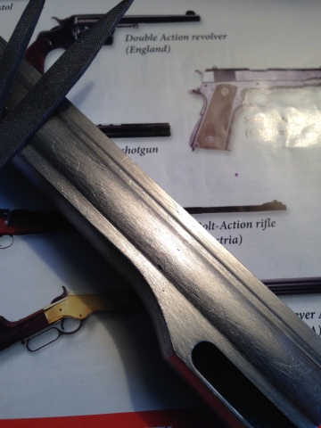

The entire lenght of the shroud leveled, mindful of not screwing up the contour. A few tiny holes will remain, however.  I don't want to go chasing them down any further and remove too much in this true labor of Dan Wesson love.

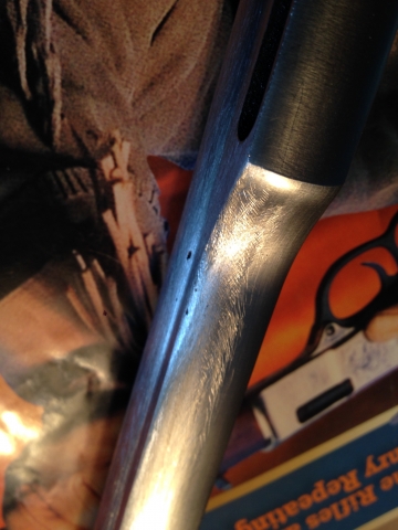

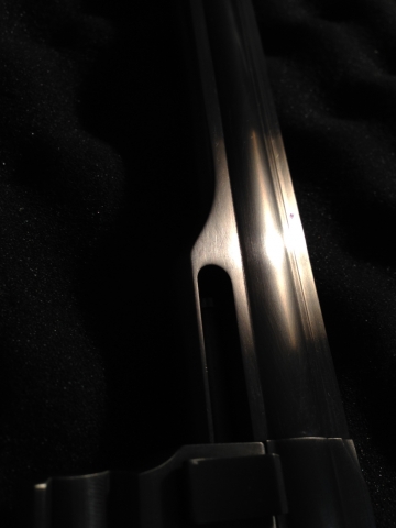

The filing done, the surface was sanded back and forth with #400 paper until the soft sheen came back, then i hit with the gray scotchbrite pad until it matched the other side. A couple of small deep pits are still there  but I'm happy with the results. Weird but I like this gun a lot more now.

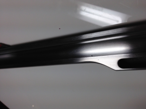

Turns out l wasn't done with it after all...image-18.jpegImage Enlarger
image-13.jpegImage Enlarger
image-15.jpegImage Enlarger
image-16.jpegImage Enlarger
Wow, thanks for the kind words. There is no real talent or anything involved other than a can-do attitude and patience. So I decided to file down the rest of the pitting and leave it as clean as possible. I learned a lot as a volunteer restoring the Armored Presidential Train Car. Lots of brass, steel and copper. I also help out with the refinishing of weather beaten Presidential Seals, Historical Markers and Plaques.
