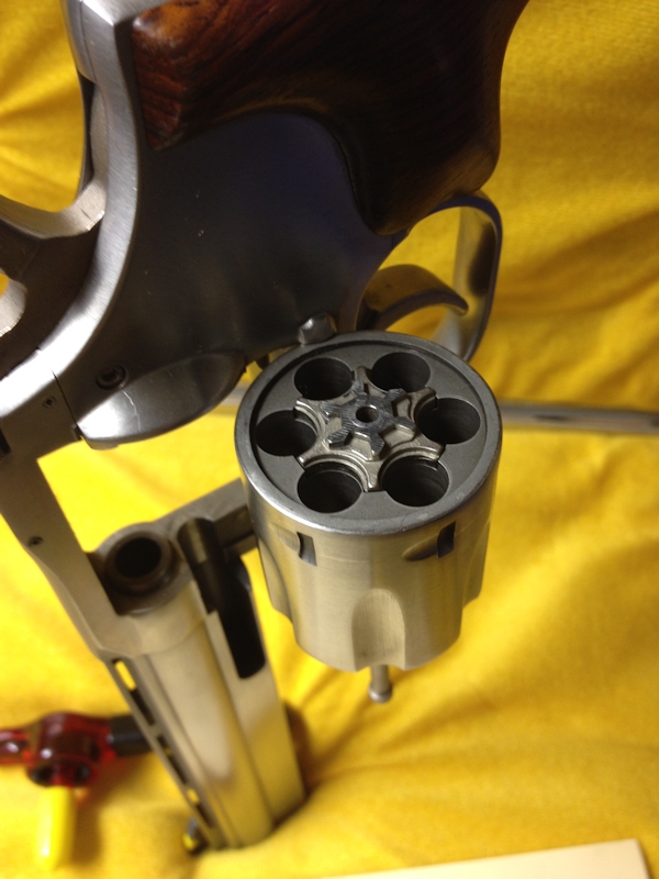

Here's the way my Monson guns show up.
My 722's, 722M, and 732M, have this kind of recess:
Recess-01_sm.jpgImage Enlarger

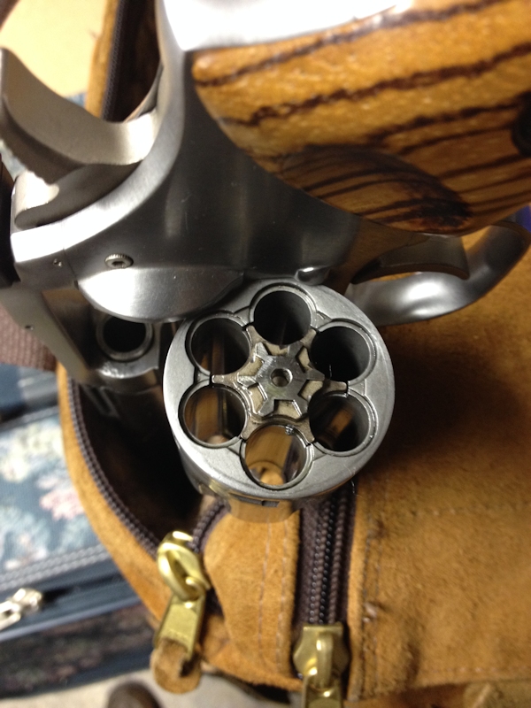

My 715 has this kind of recess:
Recess-02_sm.jpgImage Enlarger
My large frame guns; 741, 744, 745, 740, 7414, and 7445 have no recesses.
I don't know how definitive this is, but all of these are Monson guns.
