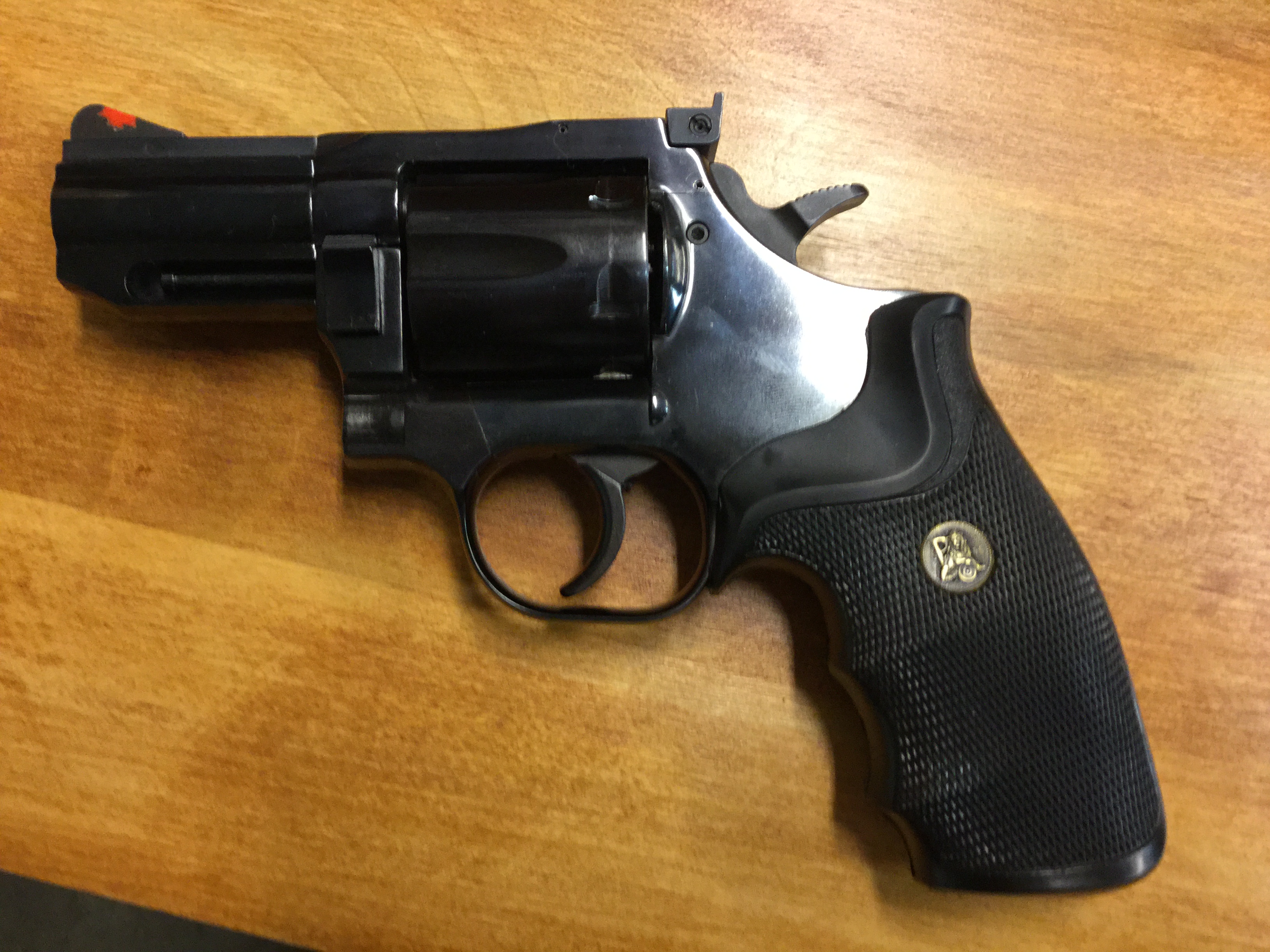

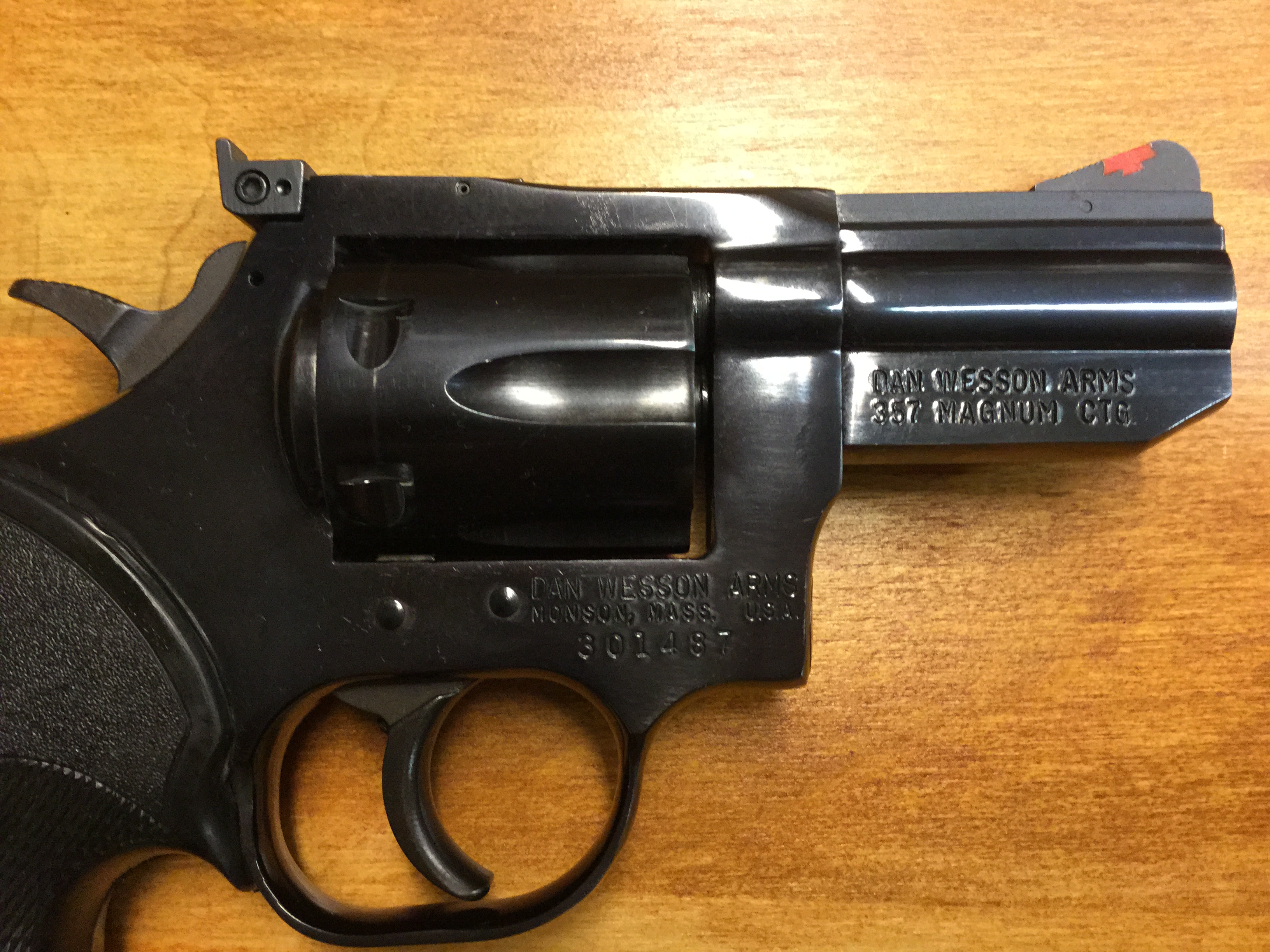

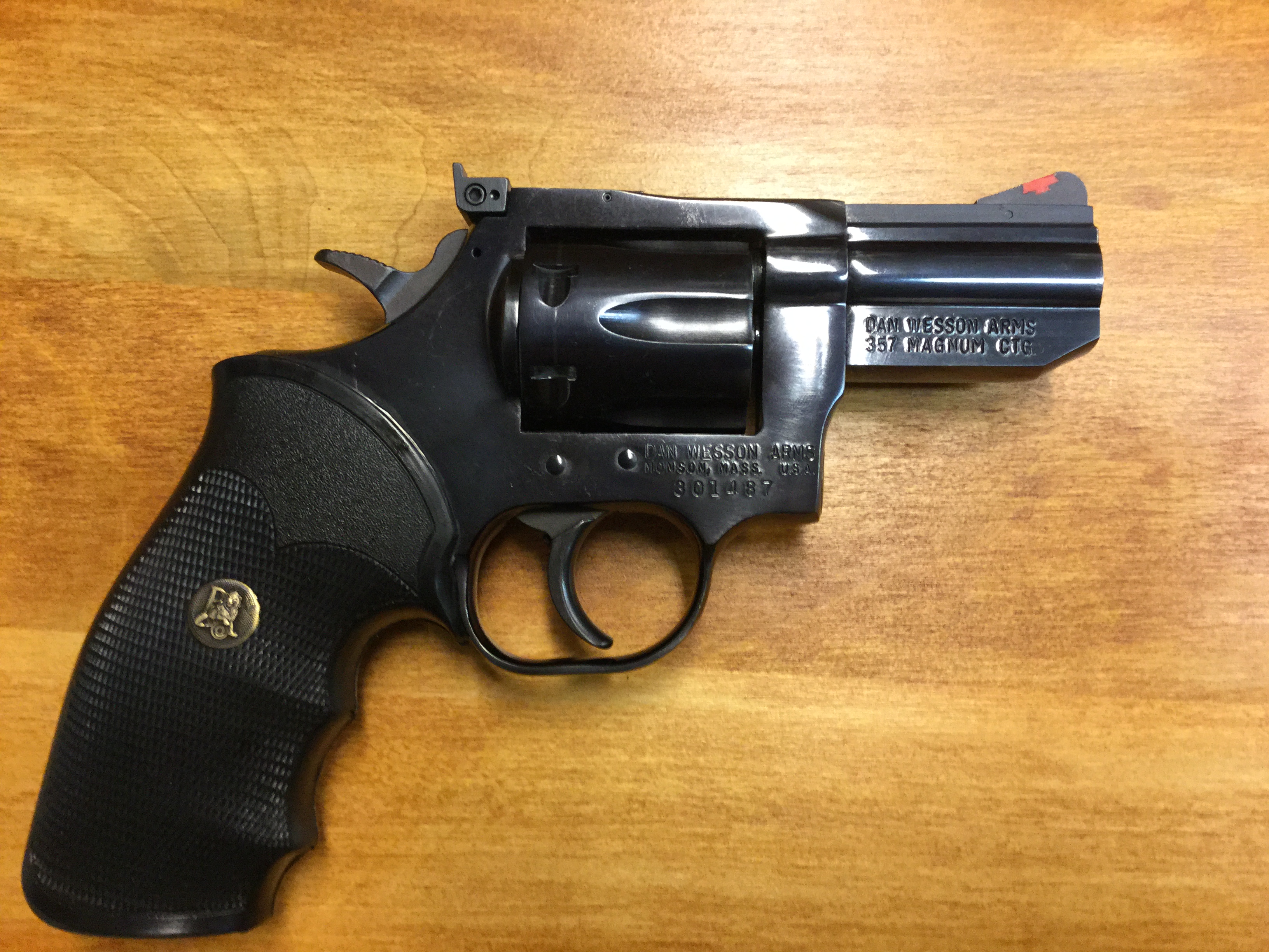

Picked this up yesterday off a local PA classified.  Any idea of the year of manufacture?  It is a Monson Serial 301487.IMG_0053.JPGImage Enlarger

March 22, 2015 - 3:02 pm
That is a 1981 gun, and with Pachmayr Grippers and a 2 1/2" barrel, its the ultimate "belly gun".
