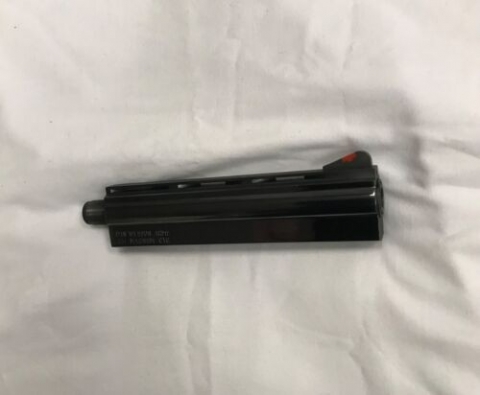

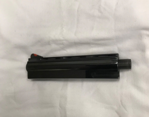

This is the barrel in question. It is not the pork chop version. Are front sight blades available that can correct the POA if needed?

Forum Posts: 4310
March 13, 2023 - 6:48 pm
If you have a 14-2 frame and want to use that shroud you can get a front sight from EWK. Dan Wesson did make lower profile front sights but I think they were for the longer (10" to 15") and they are very hard to find.
 You need to use correct terminology if you require information. That is a shroud, not a barrel. The barrel is the tube that screws into the frame. They are the same for 14-2s and 15-2s. The two together with the barrel nut are called a Barrel Assembly, or BA for short.

I will try to get my terminology correct in the future. If you read my first post I asked this "Will a 14-2 barrel (should be BA") work my bad ("fit") on a 15-2 revolver?" So no I am not trying to put this on a 14-2 frame as you state above. I have a 15-2 "frame". DW is so confusing unless you are an expert with many years experience. This is my first DW revolver or frame and BA.
Forum Posts: 3705
March 13, 2023 - 7:19 pm
Yes, I believe EWK sells 15-2 front sights that allow proper POA when mounted on a 14-2 frame.
