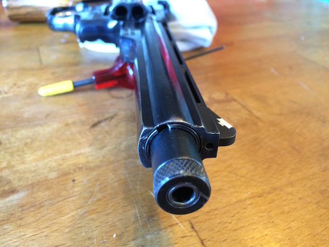

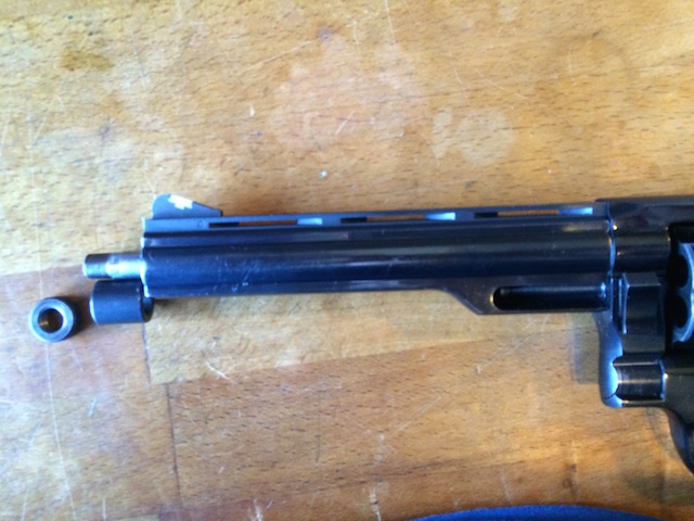

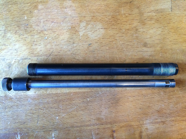

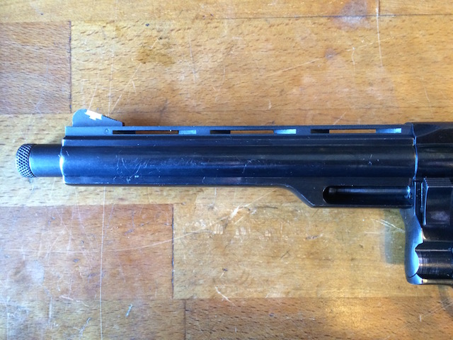

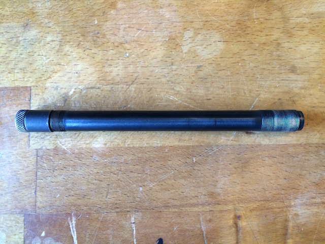

Thanks for the replies. Maybe it wasn't clear from me but:
i own a .357 with .357 barrels. The .22 barrel i have, doesn't have thread for the 357 frame. The .22 barrel can fit into a .357 barrel which I can screw into the frame.
situation is that i have a 357 frame with a .22 barrel (into the 357)
to buy another frame is no option for me, we are limited with the amount of weapons we own in the Netherlands, and a framme counts as a complete weapon according the Dutch law
ps i trie to post some pics this weekend

It sounds like someone threaded the 22 barrel (tube) to match the threads in the 357 frame, which could be dangerous if one wasn't paying attention.

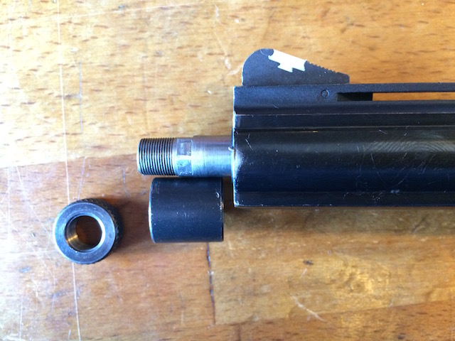

February 14, 2015 - 10:55 am
2015-02-14-16.18.26-1.jpgImage Enlarger
2015-02-14-16.18.54-1.jpgImage Enlarger
2015-02-14-16.20.25-1.jpgImage Enlarger
2015-02-14-16.20.30-1.jpgImage Enlarger
2015-02-14-16.23.06-1.jpgImage Enlarger
2015-02-14-16.23.53-1.jpgImage Enlarger
All pictures can be found here: Ray's Dutch DW Pics
Forum Posts: 5445
February 14, 2015 - 11:04 am

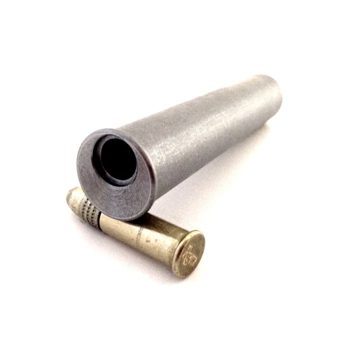

Ah; I see- a sub caliber insert.  Now this makes sense.  A picture IS worth a thousand words.  A talented metal smith could probably turn an adapter but you would have to use witness marks for installing and work out alignment issues.  A lot of potential for something to go wrong.
22_LR__410-adapter.jpgImage Enlarger
February 14, 2015 - 4:10 pm
looks like someone had a serious head start. I would bet at some point there was an insert for the chambers. In fact didn't we see something like this recently, that someone had posted????   maybe in a 22mag..  forgetful nowadays, I am.
