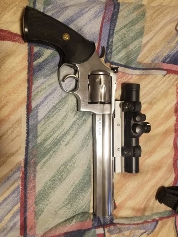

I am considering purchasing this 744 for $700.
The seller rates it 8.5 to 9 out of 10.  The seller is about 5 hours away from me and I have not had a chance to look at the gun in person yet.
I am looking for a nice revolver for a range toy.  I am mainly a semi-auto pistol person and only own a couple military revolvers, a Nagant and a break top Webley converted to 45acp with the heaviest/worst trigger I have ever found on any gun I have ever shot or messed with.
I have been looking for a good deal on a S&W but when this popped up it peaked my interest.  I have read about Dan Wesson revolvers in the past and have been reading up on them this past day.  I already reload 44 mag and have a head setup for my Dillon.  I have read a little about downloading 44 mag to 44 special velocities which seems like it would be a fun shooter for a target gun / range gun.  My 44 semi-auto requires full power loads to function and I don't find it to be unmanageable in any way... but it would be nice to be able to shoot some lighter loads... hence the 744... and I have always wanted a really nice shooting revolver with a good trigger comparable to my 1911 target pistols with worked over triggers.
Any advice on the price or the revolver would be appreciated.  Seller says he is pretty firm on the price.
No box, no paperwork, no wrench and no feeler gauge.  The Tasco scope and mount are included but I wouldn't have much use for them.  I would probably purchase a shorter barrel and keep the scope mounted for plinking and gongs.  I have read through what to look for when buying a revolver.

December 26, 2018 - 8:54 am
Welcome to the forum.
If the gun is as the seller states, it is worth the asking price.  That scope mount appears to  be a B-square clamp on mount.  They sell on eBay for 100 to 150 dollars and are in demand.  Should you decide to sell, that would help lower your out  of pocket cost.  You can get a first rate barrel wrench from EWKArms, see his link on the right side of the screen.
Check the gun carefully before buying of course.
Let us know if you need specific info, we are glad to help.
The 744 will handle any 44 load you put in it, they are very robust guns.  They also tame the recoil very well so hot loads aren't unmanageable.
Good luck.

Just got home... long day... a lot of driving... a lot of snow!  🙂

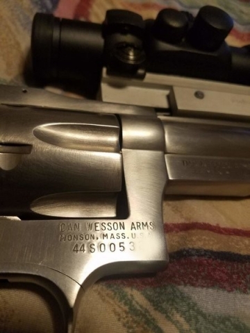

I would say the revolver is at least 8.5 to 9 out of 10 like the seller described.  Everything seems tight and well aligned to me... but quite dirty.  The seller only owned the gun for about a month... I saw where  he traded a 1911 for it on Northwest firearms about a month or so ago.  It is nice that his recollection lined up with what I found in the past online listings.  He said he only shot one cylinder full using 44  special.  At first the short ownership alarmed me... then I looked at his history and he changes firearms more often than I change my underware.
I am very impressed with the trigger, both SA and DA.  In Oregon private transfers have to go through an FFL.  While we were waiting on the background check and B.S.ing with the pawn shop owner he showed me a few of his revolvers... he is a S&W guy.  He had a Performance center S&W Model 25 (45lc) new in box.  I was very impressed with the trigger on 25 too!  I actually liked the wider trigger on the S&W a bit better... due to the width.  Weight of pull seemed about the same to me.  The DA on the 744 definitely seem superior to me.  A S&W 625 (stainless model 25) is one of the revolvers I had on my short list.  I think I will like the 744!
There are a few of the most minor scratches (more "hard rubs" because they don't really break the surface) on the 744.  They should be very easy to remove with some triple ought steel wool.  Not really any nicks that I can find.  I did check the top strap (thank you for the reminder) and see no flame cutting at all.  I just hope it has a good cylinder gap! lol2
It is very HEAVY!!!!  With the 8" barrel and scope and mount it is a lot of weight to hold steady at arms length.  I am going to be looking to lighten it up a fair bit... I hope!  I am kind of thinking of maybe going with a 4" barrel.  I will send EWK an email in the next day or two to inquire about barrels.  He doesn't list any barrels in stock... I wonder if he makes them to order?  If he machines them when the barrel is ordered I wonder if he would make a 5" barrel?  I don't know why 5", it just sounds cool to have something a bit unique.  I am open for barrel suggestions????  Mostly I will just be plinking / target shooting.  Although silhouettes does sound like they would be fun to try some day.  MY Desert L5 (Light weight 5" barrel) is about 3 pounds which makes for a nice weight.  It would be nice to have the 744 about the same weight, give or take.
The grips on the 744 are too small for my hand.  The pawn shop owner noticed this too.  He showed me his 629 with some really thick custom grips.  My Desert Eagle also has really thick grips and they do an excellent job of spreading the recoil over a large area of my palm.  It would be nice to find some really thick grips for the 744.  I really like Hogue or Pachmeyer finger grove rubber grips on my other pistols.  I think I read here that the Hogue grips for DW revolver come in small frame and large frame... with small, medium and large grip sizes available in each?  I am a pretty decent woodworker, I can make myself some custom grips if I need to... I have before and they turned out pretty nice.
I will try to post some pics soon.  I appreciate all the responses and help!
P.S. Just pulled the scope off... better weight and better balance.  I am still thinking a shorter barrel is in my future though.
