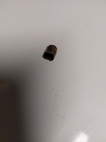

Now I have had this PP for a few months and I have been slowly going thru the different barrels. I put the 4" on yesterday and set the gap at .004 after tightening the barrel nut. Did the same for the 8" and 6" I shot before and no problems. But I put just one round in this morning to see where POI is compared to the 6" sight set up and bang. Hole in target, good.... cylinder locked up tight, not good. Came home and removed barrel and found this stuck in the cone of the barrel.
7-31-003.jpgImage Enlarger
7-31-004.jpgImage Enlarger
Looks like the jacket got hung up going into the cone and the lead slug pushed thru it and fired out thru the barrel to the target and beyond. The jacket was hanging out of the lead end of the barrel a few hundredths locking up the cylinder. When I installed the barrel I did not notice anything unusual but I did not really thoroughly eyeball it inside the bore. There is some residual in the cone area now so I am soaking it in some #9 and will clean it real good later to reinstall. What else should I be aware/looking for like a burr or ???. If there is a burr or other in this area can it be dressed with a fine file or stone without adversely affecting the function of the barrel???

The forcing cone look out of round ?
Ammo problem ?
A burr in cone or  on ammo ?
Fluke ?

Same box of ammo as shot out of the 6" barrel. I will check when I clean it in a bit for a burr or other interference. Hoping its a fluke.

First thing I'd check is the bore diameter. I've never had a jacket separate from the core. Is that manufactured or reloaded ammunition?  If reloaded, I'd also check diameter of the bullet.

It is Norma factory ammo. I used part of this box shooting thru the 6" barrel with no problems. After cleaning cone area is clean no burrs or defects. I will check bore diameter and I will check cylinder alignment in lock up again. Hoping it was a fluke with the ammo.

Ok, I did take the 715 with the 4" to the range today. First thing is I was going over the gun again and noticed that when I cocked the hammer for SA that I could spin the cylinder in the direction of rotation a good .050"+ until it stopped moving. It would do this on about half of the chambers and then the lock up would be tight with no  slop on the rest. I am now thinking my problem may lie here with a misaligned chamber. Up until now the gun never had an issue or I was just lucky. I did check the lockup when I first bought the gun and the function was correct. I will definitely need help on this one as I have never tore into a revolver before nor know what to look for first. Today I did shoot some of my 38spl loads and a .357 also. It shot without incident but I made sure the cylinder was fully in lock before pulling the trigger.

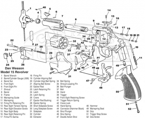

I would check the hand #38 & its spring #43 (the lever that comes up & forward out of the recoil shield & rotates the cylinder) & the bolt #37 & its spring #34 (the lever that pops up from below to engage the cylinder to lock it in place.)
The hand would be my big first suspect.
https://www.danwessonforum.com/wp-content/gallery/bullwolf/2017/02/Schematic.JPG

Much thanks! For the diagnosis and the schematic.
