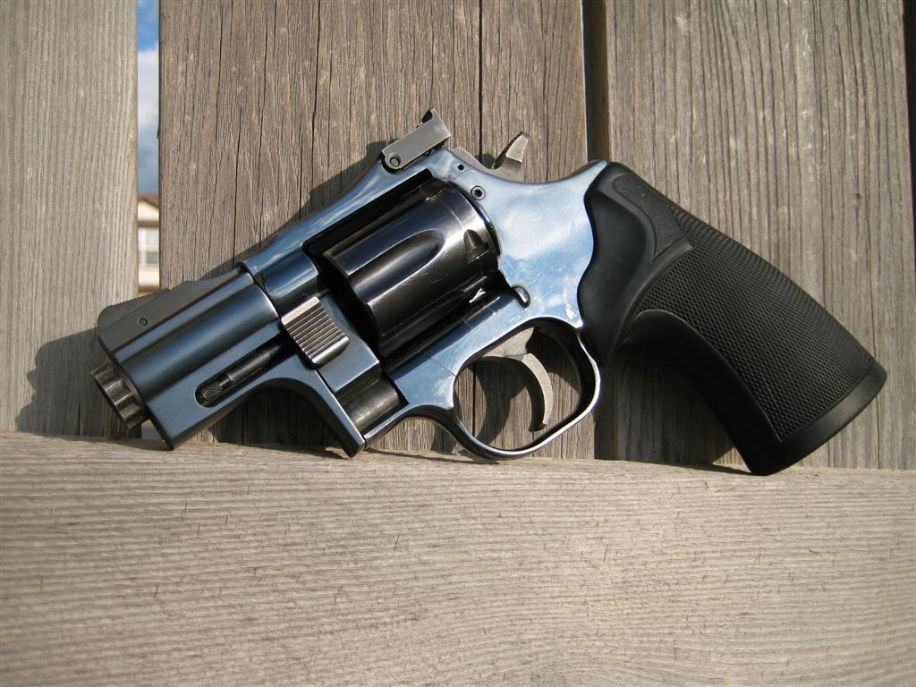

IMHO, I think snubby barrels look GREAT on Porkchops!Cool The look stout & tough, sorta like a bulldog.Laugh (I'm using Shoot's gun as an example here, cuz his pic looks perfect.)
From what I've read in magazine articles, the mushroom tip was added to the ejector rod because shooters were complaining about the original one acting like a "nail" in the palm, when ejecting & reloading fast. I assume that they made it overall longer, so there would still be a full stroke when ejecting the empty magnum shells.
I must agree, it is a bit small & I could see it making a sore palm after a while.Surprised I haven't actually tried it yet, but I assume the two rod styles will interchange with each other. I'll have to try it one day, so I know for sure.
