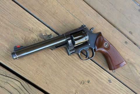

After a thorough cleaning of both of my Dans with the Lewis Lead Remover tool I proceeded to again fire both revolvers using the questionable ammo. Same result. Leading was extreme only after 15-20 rounds in both guns. The 15-1 (six inch) exhibited the worst leading in the forcing cone area, and the 15-2 (four inch) had it more in the barrel. I am of course 'stuck' with this ammo, as I can not "prove" that the ammo is the problem.
In the meantime I decided to try using my 6 inch 15-2 barrel on the 15-1. This of course creates a "FankenDan", but I'm willing to see if the forcing cone leading is less with this rather worn 15-2 barrel. I'll let you know.
Two ways to accomplish this: use an adaptor plate to be able to mount a 15-2 barrel shroud onto a pork chop frame; or, as I have done, use two barrel nuts to secure the 6 inch barrel to the pork chop shroud. The result is an interesting looking DW!
Might be pointless to ask, but has anyone else had leading problems using plated bullets at Magnum velocities, factory or otherwise?IMG_1160.jpgImage Enlarger
