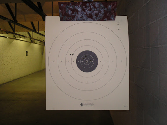

First six shots of the morning (brought the target in to photograph) Note the poor lighting.

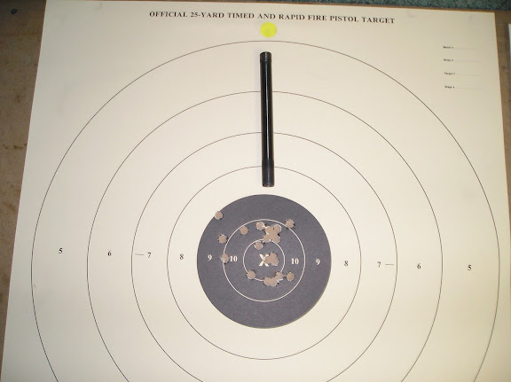

I unclipped the target and set it on the table to photograph with the barrel. Note original"flyers".
EWK Barrel. I turned the barrel sidways in the photograph so I would be sure to know which it is ( plus the color coded stickers). Once I had only half an X to shoot at it was frustrating.

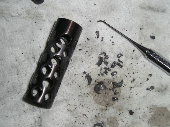

There are pictures of the lead foulings from each barrel… unfortunately, they just did not show up well in the photo, so I didnt want to waste your time loading them. However, as you can see from above..a LOT of lead was put through my old gun this weekend. Above is the dental pick I used to get the foulings out of the EWK flash enhancer.

I was going to "score" the three and then make some assessment based on the score. I will leave it to Eric to decide to so or not and what value doing such would actually have.  My unscientific conclusion is that there is more variance in the shooter than in the barrels. It would take a lot more effort to prove or disprove the accuracy of the EWK barrel. My opinion is that the barrel is 100% equivalent to the DW barrels.
Note to Eric: the cutting marks on the lands seems to have been polished near smooth within these 110 rounds.
