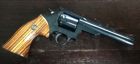

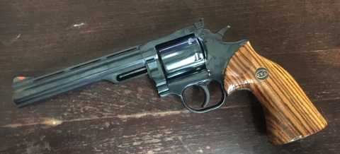

I recently picked up this excellent condition revolver for 400 out the door; I think I did well but I'd like your opinion. It's a Monson model, serial 184***. Can you tell me what year it was made from that? The action is a little sticky; is that typical? What can I do to smoothen it out? I owned a 15-2 a long time ago and it was much smoother than this one. All input is greatly appreciated!

Welcome, very nice 15-2. You did well for $400. I've seen the Zebra grips you have for as much as $150 or more. A quick look at the serial number registry here shows it as a 1979 production. If you want to check out the registry go to the top of the page and click FAQS, then click serial number registry-then look for 15-2 pages. Try backing out the trigger over travel set screw on the back side of the trigger to help trigger return problem. My 15-2 over travel screw created a divot/indentation where it contacted the frame creating an over travel issue and failure to return trigger. Unscrewing it some corrected the issue. The Gunsmithing section contains a "Average Joe" tune up which is a good read before tearing into your gun. There are folks there who can answer questions also.

Good buy
February 25, 2020 - 2:40 pm
Excellent price. You would have a hard time buying those grips alone for $200.

You did well. A good find.

Besides the Average Joe Tuneup, Wolff trigger return spring is the best way to smooth the action. The trigger pull is not easy to change because of the design but it sure does smooth the pull.
