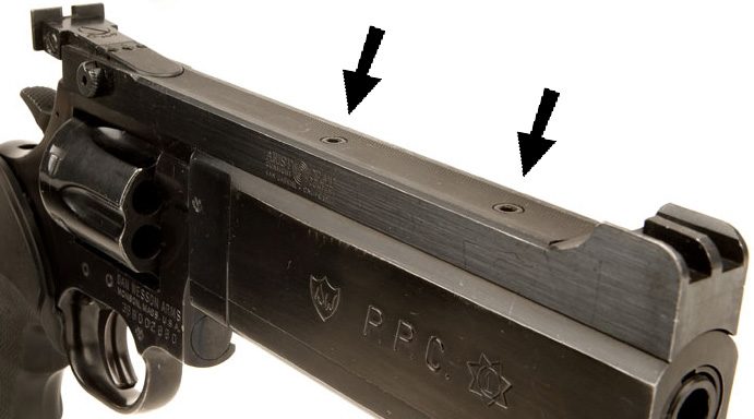

Hi
The bolts that hold the sight on my P.P.C has broken.
Does anyone know where to get new (online) or type/size. Also what size is the allen key? Im in europe (Denmark) and metric does not fit, also I tried inches, but I can find the right size.

If I were you, I'd contact Aristocrat directly.
February 5, 2012 - 5:43 pm
If you've tried both fractional & metric allen keys, then chances are the hex shaped hole is stripped. You may have to drill the heads off, then extract the threaded remains to determine what the thread pitch is & go from there.

Found the right ones...
#4-48 x 3/8" (UNF / FINE Thread size) - Imperial (Inch) - Socket Head Cap screws in Black Alloy Steel.
Uses a 3/32" Hex Key

April 27, 2016 - 6:54 pm
Prob. too late now. Sometimes w/rounded allen, you can tap a torx bit in it and it will bite. mad
