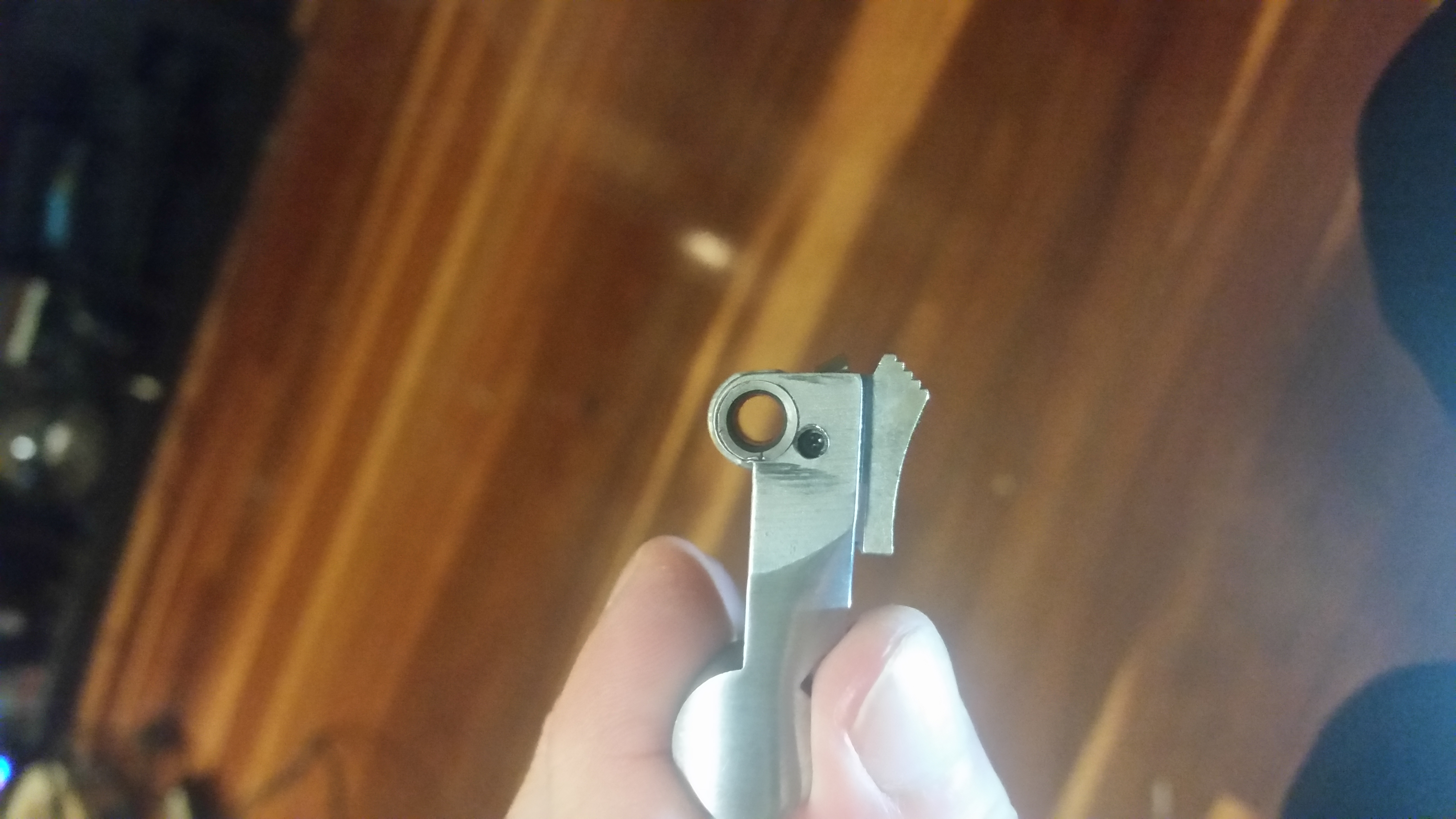

Hey guys, You wouldnt believe it but when i installed a new cylinder catch in my dan wesson 715fb i over screwed the small screw that retains the catch and it has almost disappeared into the craine thus now the catch does not move up and down. I tried to back it out but i think the bit  on the end of the small screw that the driver bit goes into is stripped.  Argg!, i should have been paying closer attention to what i was doing. Any idea how i can back the screw out or what I could do if I cant?20160803_000644.jpgImage Enlarger

I'm not sure that you will find an ez-out that small. You might try taking that part to a jeweler who has a watch repairman (repair person?) in house.
I will tell you that I once owned a 14-2 that had a roll pin in place of the screw. The gun had been refinished and I always figured the person who did the teardown/refinish/reassembly lost or stripped that screw and went with a roll pin. It worked just fine

You should be able to remove it by using a torx bit and a little downward force applied while twisting. Or file down a slightly larger allen wrench. I have used both methods on friends DW  guns that needed "special " attention to disassemble.
 I had a 22 that had a roll pin on the latch instead of screw ?
Good Luck
September 6, 2016 - 9:27 pm
Early models started with roll pins. They show up in the parts diagrams.

Hey guys good news managed to get the screw out. A few sharp taps with a brass hammer knocked it out without any damage to the latch or crane, the screw is completely striped and damaged and will need a replacement, im in Australia and cz oe ewk cant ship to me, anyone have a spare screw?
