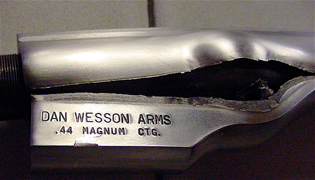

This isn't mine and hope it never happens!  Blown44Image Enlarger

Wow!  That appears to be a very obstructed barrel.  I always wondered since Dans have seperate shrouds how that would all work out if an obstruction occured.  It is rather an ugly scene.  Better for the shooter that the pressure exited there than by blowing the top off the frame.

That is for sure!   Somewhere I have a picture of a smith with out a top.  If I find I will post up!  Yeah he stacked them up had I think 2 in and the thrid came out the side!  I would think after no recoil from the first I would be looking!

I've also seen pictures of either a Smith or Ruger where the cylinder is split in two.  I would certainly like to know the story behind the shroud picture above...

Jody, he was shooting reloads, Stacked 2 and slammed the third when it blew out.
December 23, 2010 - 7:01 pm
Stacked 2? Then capped off a third? On a .44 Magnum? Do I understand this clearly?
This guy added new depth to the deep end of the Gene Pool!
Boy, I guess!WOW Screwy  "Pop, Pop, BOOM!Cry
I must say though, this is the first actual blow-up I've seen of a DW. I've previously seen pics of barrels stacked full of bullets, but this is the first actual split barrel. The others were .357's, so that's probably the difference.
