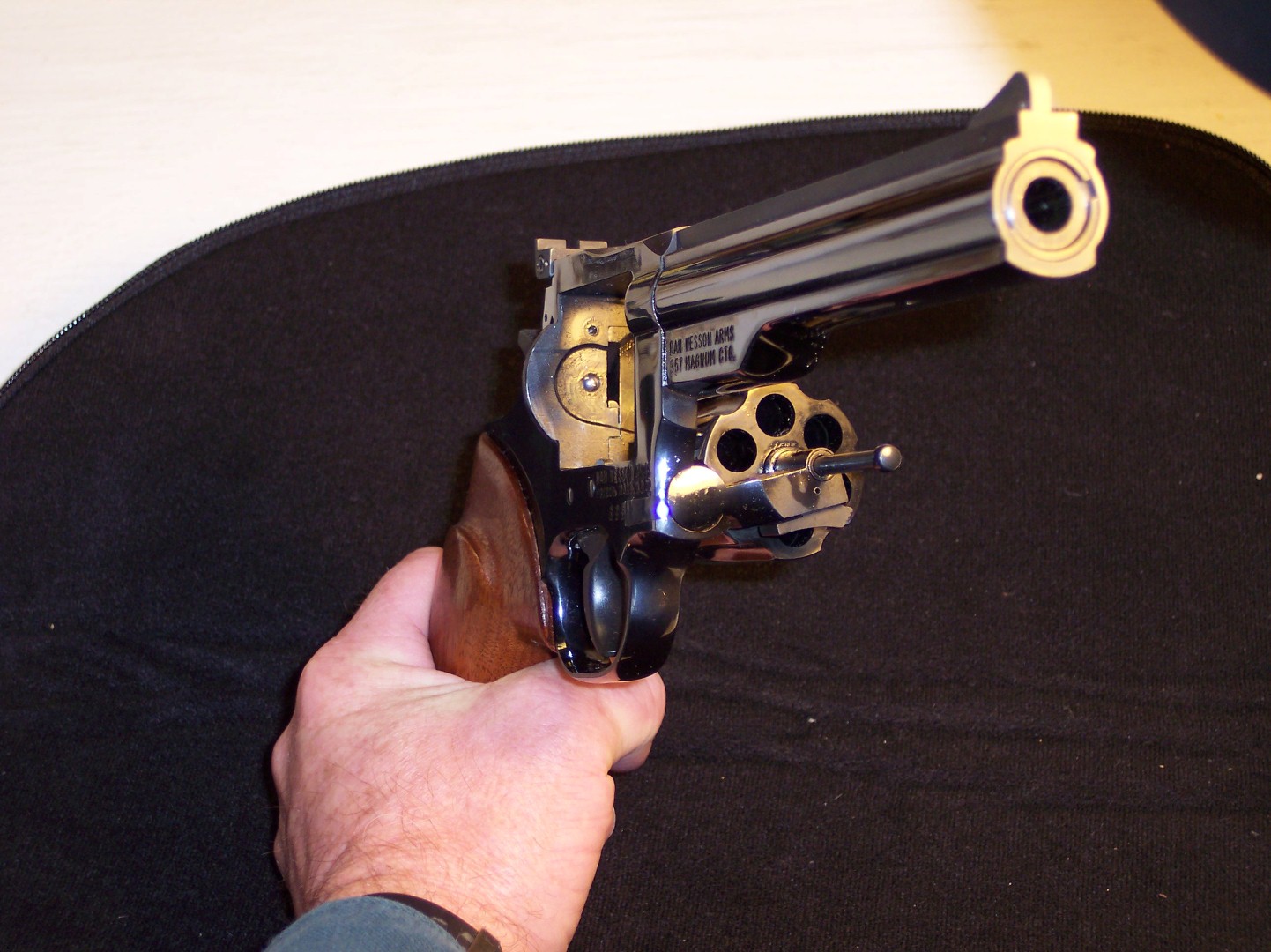

Yes, there are fixed barrel Dan Wessons. Here's a picture of the end of the barrel on a fixed Dan.

I think that price is fair for a fixed 6" barrel Dan. I would try and talk them down a little, but that's just me. Please post a few pictures if you pick it up.
There are others out there that are more skilled than me in determining if the gun is in good shape, but I'll take a shot. Look under the top strap, above the cylinder/barrel gap, and look for flame cutting. If there isn't any then the gun hasn't been shot much. A little flame cutting isn't a bad thing though. Since the barrel is fixed you'll want to check the gap between the cylinder and the barrel. Here is where someone else will have to fill you in on the correct tollerance. The non-fixed barrels are made to have a .006 gap. Check the rifling for any leading or abnormalities. Beyond that, if it feels good and the price is right to you go for it.

Here is a pic of a fixed barrel, for your knowledge-

And here is what the front of a removable barrel looks like-
006-Large.JPGImage Enlarger
