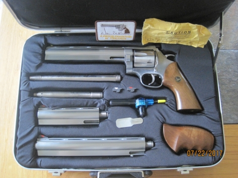

IMG_8575.JPGImage Enlarger
Hello again my daughter lives in Madison and I lived there for two years while I built Wolf Appliance also went to college there.  All barrels can be interchanged with any frame of the same caliber.  Wish you luck finding what you want there are many available.  I always look for a pack and then send question regarding pricing on GB if I think it is to high sometimes they agree and will give you a buy now option.
Above is my 44 Stainless Pistol Pack Set, love it!

A barrel assembly consists of an inner barrel tube, an outer shroud in either standard underlug, vented underlug, Heavy underlug or Heavy Vented underlug, and a barrel retention nut.  The barrel threads on the frame end are caliber specific to prevent one from accidentally putting the wrong caliber barrel on a frame., ie to prevent a .41 mag barrel to be installed on a .44 magnum, for obvious reasons.  Within a caliber, any barrel length can be installed on the frame and any style shroud slid over the barrel tube.  That is the beauty of Dan Wessons, one frame and as many different style and length barrels as you can afford, I mean want. laugh
