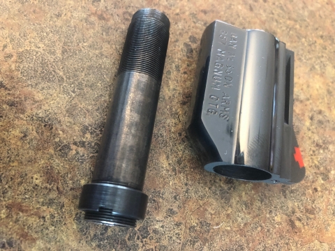

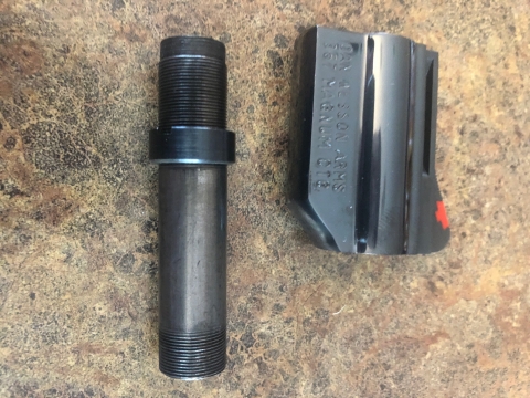

I got it in today and after being on a short hold, I was able to bring it home. Problem is I can’t get the barrel nut to tighten, everything goes on smoothly, but before I get tension, the barrel starts turning. I have tried it a few times but it is just loose. Any ideas?
February 24, 2022 - 4:58 pm
Are the threads damaged on either end? Maybe pull it apart and try spinning the barrel nut on it and verify the threads on that end are okay all the way down.  Also do same with barrel nut on the bore end.  Make sure threads are all good too.  image.jpgImage Enlarger

I got it. I had to clean the threads on the barrel nut side. They were not shiny. After running the nut on and off a few times with the barrel out it works fine now.
February 24, 2022 - 5:11 pm
Awesome!  I was thinking it had to be the threads if the barrel turned with the nut.
