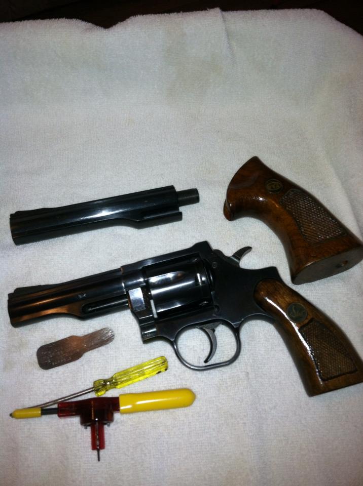

Hey folks, thanks for keeping such a nice forum for all of us to enjoy!  I just picked up a model 14-2 with a 4 inch and a 6 inch barrel.  Have a couple of questions, hope you'll bear with me.
First, it seems that the model 15 barrels/shrouds will work with the 14-2.  How about the front sights?  will it need filed down or modified in any way since the 14-2 is non-adjustable?  I'm toying with the idea of an 8 inch barrel with optics just for kicks...  really wanting to get into handgun hunting (mainly with my open sight ruger in .41 mag) but would be a cool addition to have an 8 inch revolver to squeeze as much as possible out of this .357.
Second...  I have had AWFUL experiences with taurus revolvers, 2 brand new ones have kaboomed in my hands with factory ammo and first shot in both guns.  I'm a little skittish from anything except ruger now.  I'm certainly not implying that DW is a poorly made gun, this thing feels great, but due to my past kabooms I'd like to know what I need to check out specific to a DW to make reasonably sure that it is 'safe'...  Notice the quotation marks there, I'm experienced with all types of guns and realize none are SAFE from a kaboom, but just a little advice regarding DW specifically.
Third...  When I got it, I was having an issue with the hammer not catching in single action mode, I found a reference on the internet to the grip screw needing a washer, I made a small washer for it and all seems well, is this a common issue and was this a proper fix?
Fourth...  in double action mode it seems the cylinder is turning right up until the hammer drops.  Everything seems to be locking up on "time" but this is far different from my rugers where the cylinders turn, lock, then the hammer drops.  I can easily "stage" the double action pull on my ruger, having only had this DW revolver for a couple of hours I've not figured out how to stage it by feel yet.  anyhow, does this sound proper for double action mechanics?
Fifth...  how tight do I make that barrel nut?  obviously I don't have a torque wrench to fit it, but I am a skilled mechanic so to me "really tight" would be breaking the plastic wrench...  Should it be just shy of breaking the wrench?  how about loctite, yes, no, HE%& NO?  haha
I want to thank you in advance, we do NOT have competent gunsmiths in our area but that's ok because I am a DIY guy anyhow with extensive background in "appalachian engineering" and repairing every kind of mechanical device you can think of.  I fully understand getting responses of "take it to a gunsmith"  but what I'm looking for here is just comparable mechanics to known "good" revolvers that you may have.  Thanks again!
Goober

Welcome to the Forum!  You'll soon want another Dan over another Rooger....
1- You can use a 15-2 shroud.  Just visit EWK and get a replacement front sight.  His shop is linked in the right margin.
2- +P rated all day long; no worries as long as you have a properly functioning revolver.
3- good fix.  Thanks for researching the symptom before just posting a question.
4- no issue as it is locked before the hammer falls.
5- NO locktite!  Snug is the term I'd use.  Take the wrench with you to the range so you can tighten if needed.  I prefer to use a little (slide) grease on the threads.  Some use anti sieze.  Some don't use anything.  Just take her apart every so often and clean the threads- you'll have years of shooting enjoyment.
 Finally- if you run into an issue w/ the DW- ask here, if you can't find an answer.  Plenty of experience to walk you through any problem, I'd say.
Best Regards, Ron

thanks!  I made sure to gap the cylinder correctly and all that jazz, just wanted to make sure I had the barrel tight enough, and the biggest cause of concern was the cylinder turning until the hammer fell.  I guess these are just made to a little closer tolerances than rugers, so they were able to time them a little "quicker"...
One more question, I was cruising the EWK site, found some 6 inch RH shroud only links.  Looks like these are for mounting optics, before I drop him an email (sounds like he's a busy dude) is this what I need to be looking for?  would be nifty to just keep the 6 inch and only buy a shroud.
I can see a real addiction here, I'll have to watch it!

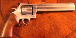

The 741- they do exist.  Start saving your pennies...

August 23, 2013 - 10:12 pm
now that is a real lust for me...  wowza.  I don't like purchasing anything off of the internet, and will probably never purchase a gun that way, I can only hope to find one someday :-)

add that to my marlin levergun in .41 mag (the one I dream about finding for sale locally), and the ruger blackhawk with 4 5/8 barrel that got me started on the .41 craze and I'd probably just let all these others go!  Might keep the .30-06 for any "long range" stuff I find myself wanting to do, but wowza, what a combo!
August 23, 2013 - 10:34 pm
Yes they do!
