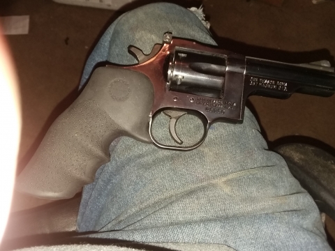

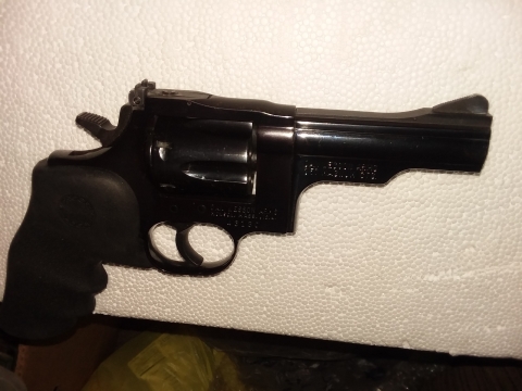

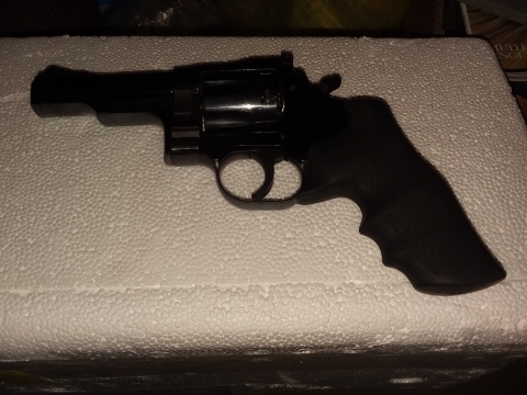

hi I have a dan wesson model 15 pork chop style shroud my question is do they make a 3 and 1/4  in barrel or how do you measure the barrel 20190116_154404.jpgImage Enlarger

They don't make a 33/4" barrel anymore. They rarely show up on ebay. Eric at EWK can probably fix you up. Also DW might also. A prior post about a rusty 15" shroud has the email of the lead Smith at Dan Wesson .

Are you saying the one on it externally measures 3 & 3/4?

yes from the front of barrel to the inside of the frame where the threads end I paid 200 dollars for the gun and it shoots straight

that is the correct length for a porkchop (which is the type of barrel shroud you have) 4 inch barrel. The later models have a 4 inch barrel which won't work for you. I don't know if Dan Wesson will make one or not, but EWK made one for me a litttle way back. It was quite reasonable price wise and shoots great. good luck.
EDIT: I realise after the fact you asked about a 3 1/4 inch barrel. No such animal. The barrel would be easy enough, the shroud would be a whole other story. You could ask Eric at EWK if he could cut a new style shroud (which he makes) to the appropriate lenth, buy one of his adapters to make it fit your frame, and make a barrel to fit. He can work out the correct shroud length. I don't know if it would be worth the cost or not but it is possible if he would do it. He does excellent work.
