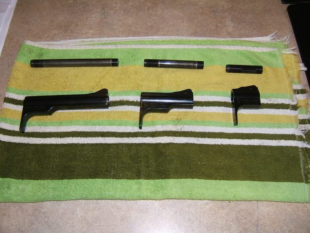

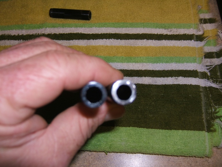

Here are the pics I took. I think I finally figured out how to load them. Here is a picture of the 6" and 4" barrels. Not sure why the 6" is so shiny on the end compared to other barrels.
It appears some of the bluing is worn on longer barrels. Not sure if this is from use or sitting in a safe for many years.

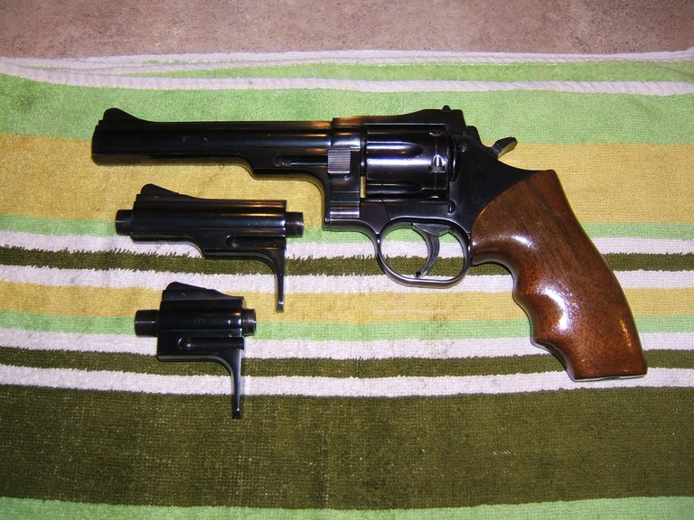

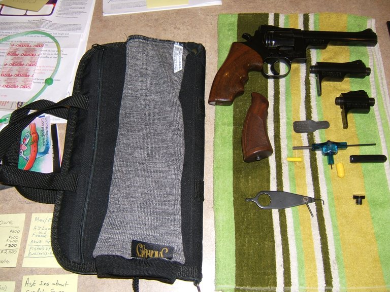

 This is everything I got for $550. Looks like an original barrel tool and a newer style.
There is some wear along lines, but not bad for a 40 year old (I think) gun.

Judging from the shiny barrel end & the additional finish wear on the 6" shroud, I would guess that the previous owner probably shot that barrel primarily. From the pics & your description, it looks like you found yourself an excellent M14 Porkchop, way to go!Laugh
