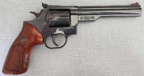

Just wanted to say howdy. I am new to the forum as I recently acquired a new to me 15-2. Been collecting S&W wheel guns for a while, but this is my first DW. Didn't even know about them until a few years ago, then by luck one fell into my lap recently and I had to have it. Nothing too special about it as far as I can tell, but it is in great shape and is quite accurate. From somewhere in 1978 best I can tell based on serial number collections I found here (thanks to all who have contributed). Would be interested if anyone knows how to get any more detail than that if possible. Take care and happy shooting.

Forgot to include the pic! Sorry...

That's a great looking, super clean entry you have discovered into what may be many more DW's to come your way. I hope it came to you at a favorable price...these days the ask can be kinda crazy. surprised
We would love to see a few more cool-pics of that one! drool

Wow; that’s one of the cleanest DW’s I’ve ever seen here on the forum. The vintage you’ve stated is correct, and it’s an interesting period. I notice it still has the trigger over travel screw on the trigger (later ones have it in the frame). This is right about the time DW changed the cylinder/crane arrangement from the system on the early guns (removable gas collar insert) to an improved version. If you could give us a good clear photo of the cylinder swung out we might be able to tell if you have one of the last of the old, or one of the first of the new.

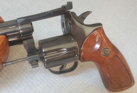

Like this?
dw04.jpgImage Enlarger
Forum Posts: 669
October 17, 2017
September 1, 2022 - 4:37 pm
Yes, great photo, showing exactly what we’re looking for. This is probably one of the last 15-2’s that still has the old style cylinder/crane. The cylinder collar (gas ring) is a separate piece that fits snugly into a pocket in the front of the cylinder. It CAN be removed, but no real need to do so. Most of them fit very tightly, and some come out more easily. I would advise just leaving it alone. These early DW’s are very much like the Colt’s from 1966 to the present day with the collar resting directly on the frame. Later guns have a “flange” on the upper crane leg that the (shorter) collar rests against; a little bit like a S&W.

Great info, thank you very much. I had it stripped not too long ago for an initial cleaning, but didn't know about the gas ring. I am inclined to leave it alone as you say, but next time it is apart I am going to take a harder look. Appreciate the context.

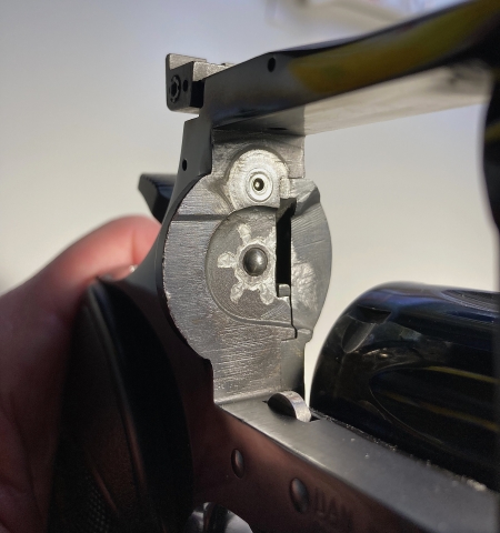

Thanks, Charger Fan; I always strive for accurate information. I hope the attached photo of my 15-2 gives sjk141 a full appreciation of the condition of his recent purchase. If anyone has a more abused 15-2 than mine please post a photo! sjk141, you can shoot your 15-2 forever; just don’t feed it a disproportionate number of super hot .357’s.IMG_0934.jpgImage Enlarger

>Charger Fan - this one was definitely fired. When I had it stripped for cleaning I took out a lot of carbon, and it does have evidence on the shield, I just think the photograph is a bad angle and/or misleading.

Actually, there’s more going on here besides cosmetics. The previous owner of my 15-2 was apparently trying to rub elbows with the .44 Magnum with it, resulting in such extreme peening of both ends of the frame that far too much endplay developed. The only way I could bring it back to a reasonable spec was to install a replacement gas collar a full .015 longer than the original. As a result the headspace has been reduced to .057  Most .38/.357 case heads are around .054 which barely clear, but some are .057 or even more which rub the recoil shield, even with a cold gun. So, for every .001 I take off the gas collar I increase the endplay along with the headspace. I don’t like more than .003 endplay, so I’m stuck using only certain brands of ammo. These woes are nonexistent for those lucky owners of non-abused revolvers.
