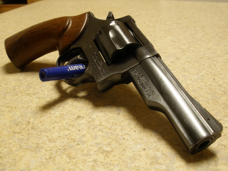

 I decided to buy a revolver for my first gun, primarily for home protection.  I was on a budget so my choices were very limited.  I found this revolver at a pawn shop and paid $200 for it.  I do not Know much about guns, so i have been doing some research to find out what model it is.  I share some of the frustration a previous member of this forum talked about in that i don't know all the jargon to be able to identify my gun.  I do know that it was made in Monson.  the serial # is 66708 and it has a fixed sight in front of the hammer.   I guess this means it is a service model. It has a 3 1/4″ barrel.   I really want to know:
1. What model is it exactly?
2. Was $200 a good deal?
3. Will it really hurt to use 38 Sp. +P cartridges ( A manual on DW .357 says it's not recommended)
4. Can an adj. sight be added?   THANKS IN ADVANCE!!!!!Image Enlarger

It looks like you have a small frame model 14 service revolver. From what I can see of it's condition, I think you did pretty well on the price. It should have a removeable barrel (can't make out a barrel nut on this crappy monitor), so you should be able to swap barrels. The only downside is that if you use a barrel that's designed for interchangeable sights, it may throw your aim off when shooting. Due to the fixed rear sight.

What you have is a post 1974 Model 14-2.  As you noted, it is the Service model not the target model.  -->better for concealed carry with the fixed sights.
It's a nice looking gun from your pic!  If the bore is clean & the gun is tight, you got a very good deal at $200.  I see them on gunbroker usually ~$300 or more.
Barrels are interchangable & are meant to be changed!  You need a barrel wrench to take that nut off the muzzle, then the "shroud" around the barrel slides off and the barrel itself unscrews easily from the body.  To put it back together or change barrel / shrouds, you'll need a feeler gauge to set the gap between the barrel and cylinder.  Factory spec. is .006, but I think most folks run them a little tighter ~.003 or .004 depending on how parallel the barrel and cylinder face are (as it rotates).  Wrench and gauge frequently on GB and also available from DW for $43 + shipping.
You can use barrels & shrouds from any model 14-2 or a target model (15-2). However, with the interchangable front blades on a model 15,  you must use "blank blades" from the factory and file them down.  The model 14 fixed front sight is lower than the interchangable blades.  See this post on the topic: https://www.danwessonforum.com/?page_id=3/revolvers/front-sight-heights&value=model%14%25front%25sight%252&search=2&ret=all  Additionally, Model 14's were "Satin Blue" finish & 15's were "Brite Blue" finish, so they won't be a perfect match.

What makes it a Model 14 instead of a 15?  It does have a barrel nut and it looks like fixed barrels are not only hard to find but made in Palmer not Monson.

The differences between the M14 and M15 are the sights and the options offered for the shrouds.
M14: fixed sights (machined rear, ramp front) and only the standard shroud - meaning it is not available in the "Heavy" target config with the full underlug & the top rail is only available "standard" - no vent.
M15: adjustable target sights rear, interchangable colored blade front.  Shrouds available in numerous configurations.
  • 15-2: no underlug, no vent (std.)
  • 15-2H: with underlug, no vent
  • 15-2V: no underlug, w/ vented rib
  • 15-2VH: with underlug, w/ vented rib
Check this brochure under the files tab:

Model 14-2 with a 4" barrel.  At $200 I'd say you did very well.  I actually can't tell from the pic if it's blued or stainless, looks dull grey on my monitor.  Stainless would be a model 714
