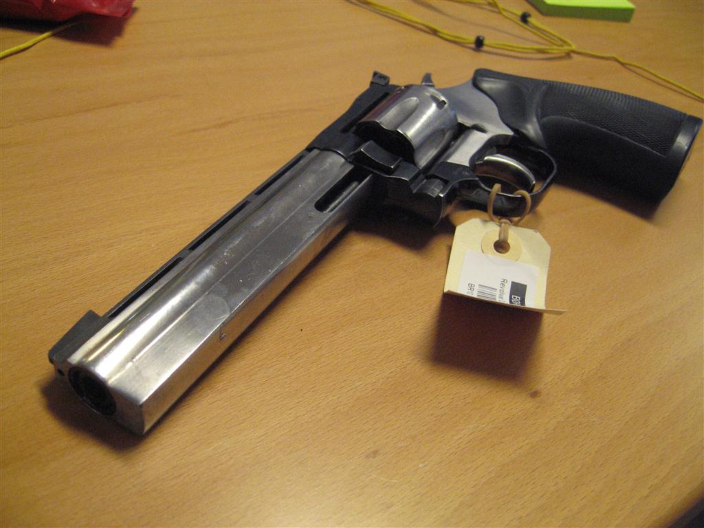

Hello guys, just bought myself a .357 DW.
Seems to be some years old, ant som previous owner has "had its way" with it, tried to polish of the blueing on the shroud, barrel and coverplate.....
I decided to buy it, since I dont have a revolver, and my approval for a .357 was about to expire...
Asking price was 250$, got it for 170$, which in Norway would be dirtcheap even for an unusable lump of metal and even an non-functionable firearmImage Enlarger
Only thing now, is seeing how this puppy shoots...Mini Gun

Hey ...thats dirt cheap here as well,  you made a good buy !  I would look into
cold bluing it yourself at the very least, that bare metal will be a chore to keep.

The previous owner did a nice job polishing the shroud & side plate, it almost looks stainless from here.Cool I agree with Blacktop, leaving it bare would probably be a pain to keep from rusting.
Looks like a nice one, congrats on your find!GTDW

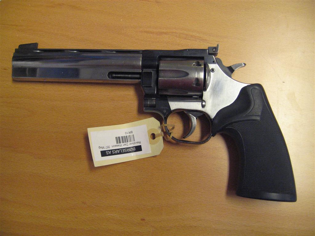

Blacktop, Charger Fan, DWA_Midwest: part of the reason I did buy this gun was because of the finish since i have allway wanted a "stainless gun". This said, something has to be done, since there was small traces of rust on the barrel when I bought it. Have been thinking about getting a new finish on it,  chrome perhaps. Norway is a small country, the shooting community tiny, and the people who actually perform are only a few, but I think I may have found the right ones for the job. A guesstimate i have been quoted was approx 200$, and that was with a good overhead. Seem like a good company and have heard that they have done guns before too. http://centrumfornikling.no/

Had her on the range by the way, some previos motherf***** have mounted the barrel with NO clerance between the barrel and cylinder WHATSOEVERrange-time
This resulted in one shot getting fired, then it all locked up TIGHTLY. Couldn't cycle, couldn't open the cylinder, stuck.... That motherf***** has also tightened the nut for king and country, almost stripping the notches on it, so wrench and new nut is on the top of my wishlist.

Careful trying to get that barrel nut off.... you need LOTS of patience and just a LITTLE muscle...laugh  And of course a good wrench from EWK...
While you are waiting for the wrench to arrive, start soaking the end of the barrel in penetrating oil of any kind, it can't hurt.  Also squirt some penetrant into the threads on the frame end--sometimes they will unscrew from the frame easier.
