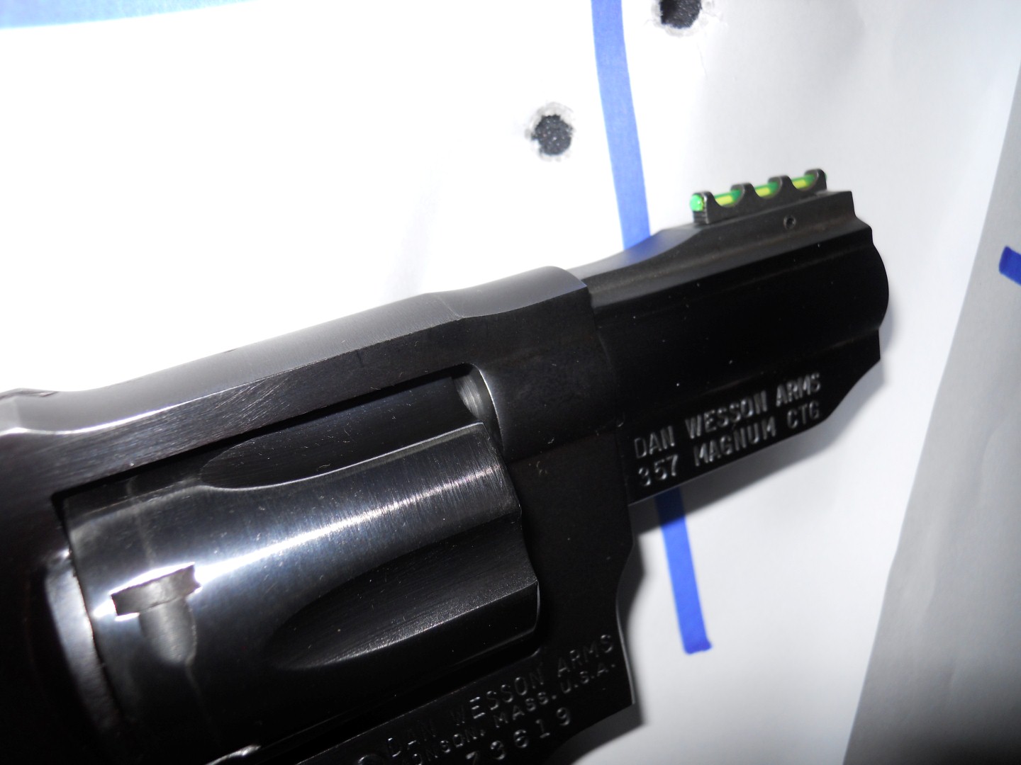

   I have a model 14-2, just a later version of your revolver. I bought the EWK FO sight which fits model 15-2s and modified it. I had to take my barrel to a gunsmith and have the original pin drilled out as I could not drive it out. I then cut down the EWK sight which is taller and drilled it and pinned it in my barrel. I used a split pin to make it easier to remove later if I need.
   I actually made the height of the sight dead on with the ammo I use in the gun. Kept cutting it down a little bit until I got the right height. Which required several trips to the range. I taped the sight to the barrel with electrical tape for trial runs. This sight is really my second effort, the first one I fastened on with a rubber band for a trial run. On about the third shot the rubber band flew off with the fo sight! I never did find it.
DSCN0010-Large.JPGImage Enlarger
