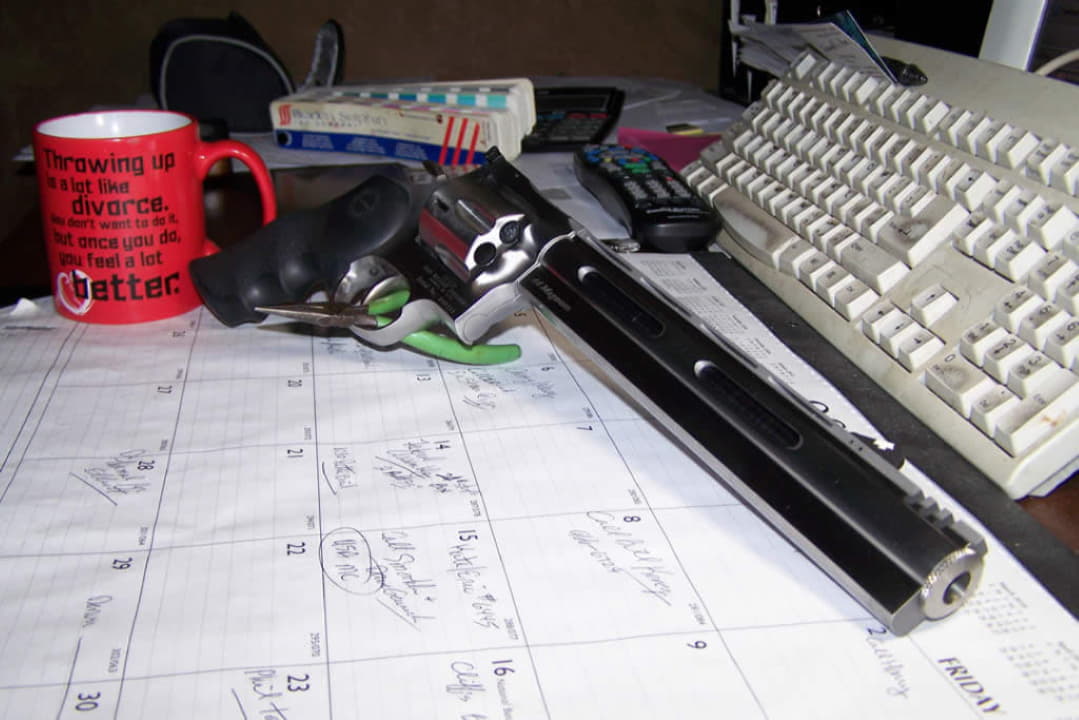

Here's a .44 Mag with a compensated BA. The nut is behind the muzzle about 1-3/4". The front nut is removed by hand and then the extended wrench slips into the muzzle to remove the barrel nut which is like a regular barrel nut.

Thanks for the picture jaggman, I see the difference now. I think I'll look for a short compensated  barrel. The Hogue grips look good to.
