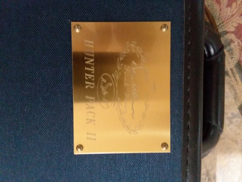

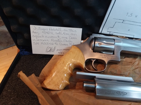

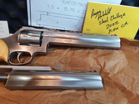

Then again their is this,20210803_193918.jpgImage Enlarger
I'm fairly certain this is a Hunter Pack20210803_195023.jpgImage Enlarger
20210803_195016.jpgImage Enlarger
Forum Posts: 1697
August 3, 2021 - 8:45 pm
Very Nice, Hunter Pack II!
Nice Hunter Pack II! I probably should have limited my reply to Monson era Hunter Packs, since the original post was about a Monson era Pistol Pack.

willy said
Then again their is this, I'm fairly certain this is a Hunter Pack
laughing
That's a Norwich First Issue .. very nice set.
