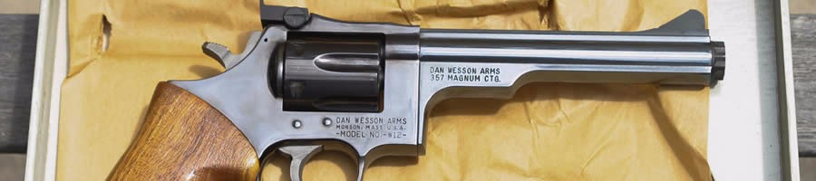

I just joined because I'm thinking of buying a DW revolver, but I've never seen this type of barrel nut.  I sure it's common to you folks that's why I'm asking here.  I don't have a picture but there are two revolver with this barrel nut in the banner at the top of the page.  The are in the forth and fifth pictures after the "Dan Wesson Arms" banner.

As to the barrel nut, a pic would really help but it sounds like you may be describing an external nut.  Does it look somewhat like a 12 pointed bolt?  Those were used on the early model 11 and 12 guns.  A pic will narrow it down.  The banner at the top rotates to different pics so can't tell by that.

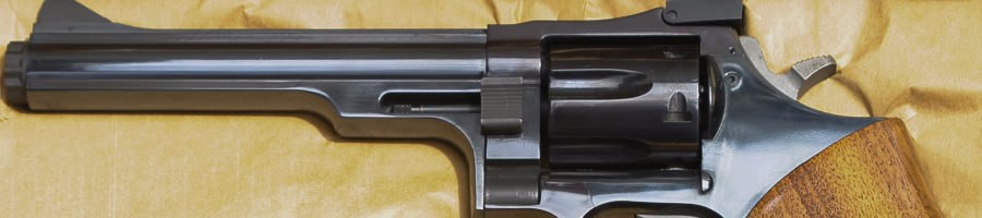

Hi - Welcome.  Unfortunately, the order of the pics in the banner appears to be random so when you see the pic you want, just write click on the image, and save it to your hard drive.  Then respond to this thread and use the attachment tab to put it in your post.
I'm assuming this is what you're asking about.  It's a Model 12 (and that nut is also used on a Model 11).

Thank you very much, folks.  Thanks to your replies, I see that it is an early model revolver.  I visited the gun store a little while ago and the model number is -W12-.  There are 4 digits on the frame under the yoke, but I don't know whether these are the serial number or some manufacturing numbers.

I am confused about the barrel change discussion. I have rarely seen a shot out Dan Wesson barrel. If it was well worn because of use as opposed to age, it is easily replaced at a small fraction of the cost of any other revolver. The model 11 or 12 uses the longer barrels as opposed to the scarce 1/4"shorter barrels of the later porkchops. The Wessons are selling 12 sided nuts of new manufacturing.. I think you could use them on a 14 or 15 porkchop and not need to find a 1/4" shorter barrel too.
