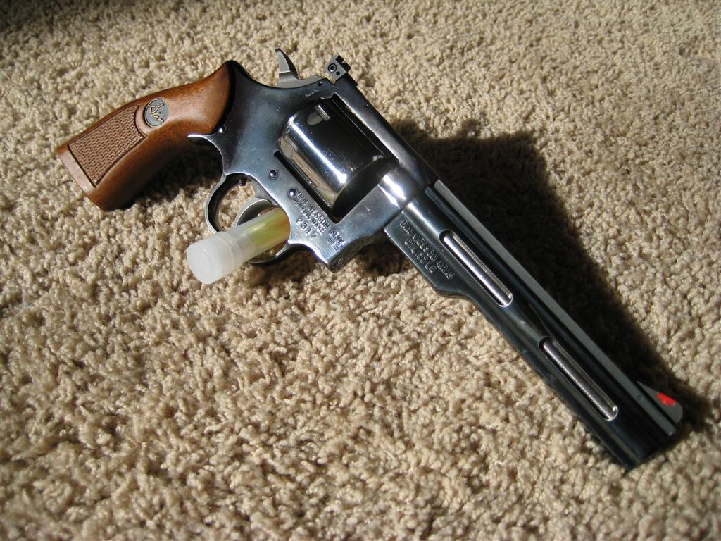

Well, it took a little bit of work, but my Custom DW22 is finally done 🙂  It went from a stock 4" gun to a real beauty--here's the original pic...
And here is what she ended up as... 🙂 I installed a one-off original DW unfluted SS cylinder and SS barrel, and then slotted the shroud.  When it gets nice outside I'll take some better pics.  I still need to polish up the barrel a little more to match the cylinder.  I hope she shoots as good as she looks !

That's a great looking firearm. Nice job.
I am sure it will shoot well- it is a DW after all. Let us know how it does after getting a few rounds down the pipe.

That's a great looking DW, nice work!Cool  So, do you have a local machinist doing the shroud slots for you, or do you send them off to DW?
February 27, 2010 - 5:01 pm
My local FFL guy has a vertical mill, so I've been letting him practice on my shrouds 🙂  That's why I gave him the beater 14-2 shroud first.  He is getting the hang of it, my slots are a little wider than they started out, he had to do some cleanup work.  I am very satisfied with the work, he gives me exactly what I ask for.

Did you do the rebluing yourself after the slot work was done?
February 27, 2010 - 5:49 pm
yea, I just did a touch up with cold blue.  Just like the 14-2--some day Hotbluer will get a box full of shrouds from me 🙂

SHOOT, did you have any issues with timing once you dropped in the new cylinder?
February 27, 2010 - 7:02 pm
Jody said:SHOOT, did you have any issues with timing once you dropped in the new cylinder?
I had to do some fitting--took .006 off the length to fit it in the frame.  Had to take a little bit off the back of the hand to get the rotation just perfect.  I['m hoping it is a tack driver--if it warms up this week I'll try it out.

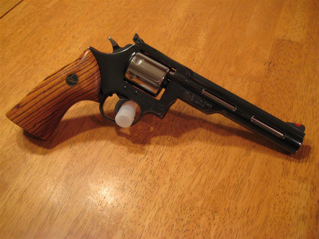

Is it the angle of the picture, or does the grip really make the gun look big?
-Wayne
February 27, 2010 - 10:41 pm
Might be the angle, but it looks like a small grip too.
Mike said it first, Zebra makes it perfect
February 27, 2010 - 10:47 pm
Man--you guys are tough 🙂  I tried every grip I own on the gun before I posted a pic... I thought the smaller grip looked better... guess I need to go try them again and post another pic with a zebra 😉

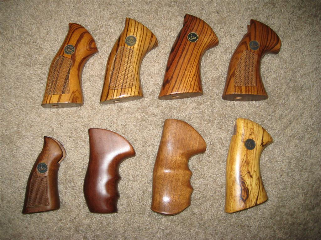

Just to show you the difference in a few grip sizes....
And here was my final choice... the smooth zebras.... 🙂  The dark stripes seemed to go better with the gun.

Awesome, you can really see the contrast in that picture. What an eye catcher!Cool Pics
