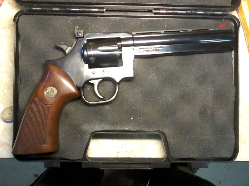

Hi,
My first post so bear with me.
I came upon a Monson made Dan Wesson model 22 with the heavy and fluted barrel.
It was cheap for Finnish standards. I only paid a little to much for it and not a lot like usually over here. The gun had seen some action but was in quite good shape. It was some 300 euros (414 USD).
I managed to put a few hundred rounds through it and noticed some problems. One of the chambers make a noticeably different noise when shooting. Also I got some misfires in double action. I say "got" because the connector broke on the last session. The misfiring might have been a symptom of there being something wrong with the connector in the first place. I don't know. Also I found a lot of lead shavings, but then again the end play on the cylinder was way of ( no where near the .006 inches it is supposed to be).
I started investigating the whole Dan Wesson phenomena locally, since there aren't too many here in Finland. The thought of having interchangeable barrels on a handgun, even in the same calibre, is nothing the government really likes. I would have to have stamped and approved barrels and get a license for every single one. I don't know if this also is the reason why the gun didn't include the Dan Wesson multi tool or the end play gauge.
When looking for spares (eg. the connector), I found that Midway in Finland sells Wolff Shooter's Spring Pack Dan Wesson Small Frame Revolvers Reduced Power.
The Finnish importer (Remes Oy) is having a hard time finding spares, ore more accurately, to get spares sent from USA to Finland. I'm starting to think that I'll have to make the connector myself. I don't know why, but it seems to be hard to get any gun parts sent abroad from the US at the moment. (Now even harder because of our beloved neighbour Vladimir something or what ever...).
Putting all this aside I have a few questions for you more experienced DW owners.
1. Does anyone have the exact thread measurements for the barrel to action thread? Also the thread for the bolt holding the barrel shroud. Of course specific for the mod 22. Barrels are something I most definitely would have to manufacture myself.
2. Is the Wolff spring set something to have in a rimfire pistol. Doesn't it weaken the hammer impact to much?
3. If the cylinder is burnt and pitted on the edges, is it worth turning it in the lathe to even out the burns, or should I just order a new one (... if I even can get one to Finland... By the way, the cylinder is also a gun part that requires a purchasing licence from the government..).
Thanks a bunch in advance for your thoughts.
V__25031.jpgImage Enlarger

I managed to make a connector out of a piece of metal. It's not as nice as the original was, but it works. I took it to the range today and found it working just fine.
After adjusting the end play of the cylinder (to .006"), I even could notice a change in accuracy. I'm still waiting for the new spring set though. Let's hope it will arrive soon.
Yes and I added the picture I promised in the beginning.
