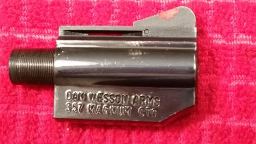

I've noticed that some .357 Monson 2-1/2" barrel shrouds have a curved underlug cut and some have a straight cut. Why have a different cut between Standard and Vented? Presumably, the Heavy goes all the way flush with the muzzle?
Any information greatly appreciated. Here are some current examples on FeeBay;
Curved Standard
Vented Straight

Straight is for heavy underlug, curved for light underlug. Look at pistol packs, needed some form of differentiation and for an ascetic point, very nice.

That's what I told someone on FeeBay that was selling one with a straight cut and he assured me that Heavy's went out flush with the muzzle crown.  I checked Jody's "What model do I have?" thread and his pic showed a Heavy 2-1/2" with it being flush.
My PP from 1979 is a 15-2 Vented and the 2-1/2" shroud has a straight cut.  Thus the reason for this thread.
August 15, 2016 - 11:19 am
Just thought of something ... could it be that a Vented Heavy shroud might have a straight cut because it is Vented, but a Heavy only is flush.  That might be confusing the issue.
Who has a Heavy PP that can check theirs for us ?
August 15, 2016 - 11:51 am
I believe the Heavy underlug ba's are straight cut and most were vented.
The standard underlug is cut up at end and will match the cut on the longer ba's, just past ejector slot.
It is too short to see the "standard ba look". And could be vented or not.
No PP to check, but I think this is true.

The pics he has tagged, show a vented barrel assembly. Why one also has a concave cut line I don't know? Maybe I'm not done with collecting yet also.

After enlarging the pics of the curved cut, it is indeed a Vented shroud.  Mystery continues ...

Heavy under-lug= square at the muzzle regardless if it is vented or not.
Half lug or standard curves up just after the ejector slot regardless if it is vented or not.
On a 2 1/2 shroud the curve ends at the 2 1/2 point.
The exception to this is some of the fixed barrels have a similar bevel at the muzzle.
Some where on here are pictures of all that, but I seem to have issues finding them right now.
Hope this answers the question.

Let me try thiss-l1600.jpgImage Enlarger
s-l2500.jpgImage Enlarger
August 15, 2016 - 9:05 pm
I think a former Smith and Wesson employee must have started working for Dan Wesson and it slipped past quality control. You could put it on ebay and say Rare, Rare, Rare and get twice the going rate. Seriously, standard and vent have the slanted cut regardless of the rib. Heavy and vent heavy the lug is flush with the muzzle. Fixed barrel lugs were like the heavy but with a slant at the end regardless of length. I believe they also sold some of the fixed barrel types separately during the Palmer years. I have a stainless 3 inch and a stainless 6 inch with the full lug and slanted cut. I also have a blue Norwalk 3 inch heavy Lug. I consider the 3 inch priceless. Haha.  Consider the 3" Python. I'm so funny. One day I may build a 3,5,7 pack. Still need a 5 and 7.

Good examples!
Those are both standard shrouds...the top is non-vented & the bottom vented. Heavy shrouds will have the same options on the top rib, but will come straight out & squared off at the bottom...just like the longer barrel versions do.

No your missing this, if you blow the top photo up it's vented also. But that's not what he was talking about. It's the concave of the diagonal cut on the top picture.

Thanks for putting my example images up Willy, FeeBay wouldn't let my iPad copy them.
occasion
August 16, 2016 - 8:29 am
There is a difference in the radius of the concave, however I always "assumed" that was just the guy who was running the finish sander that day.
