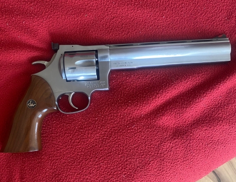

IMG_1804-1.jpegImage Enlarger
IMG_1805-1.jpegImage Enlarger
IMG_1806.jpegImage Enlarger
I just acquired a 744VH8 (Monson manufactured) with ported shroud and barrel.  I picked it up in a lot of firearms and know little about these pistols.

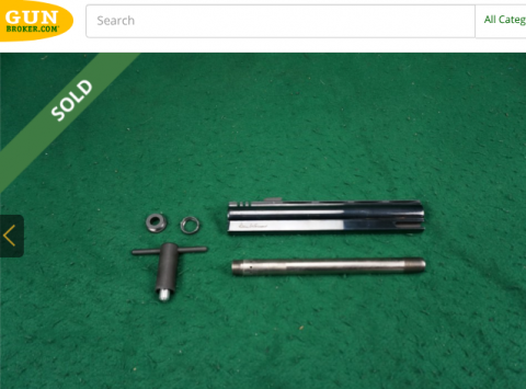

You guys may remember this for sale last week on GB. I started looking at it and then alarms went off. It was a newer Palmer compensated shroud but the barrel was an old type power control barrel. I kept thinking if whoever bought that tried to shoot it like that it would end well. The old style barrel with the 6 holes drilled in it. That means the holes would be Screenshot-2025-03-10-8.41.11-AM.pngImage Enlarger
Screenshot-2025-03-10-8.41.36-AM.pngImage Enlarger
behind the barrel nut so the gas would have nowhere to go but I guess out the barrel. would this have been dangerous to fire like that? Seems to me it would be but then again the gas could just not go anywhere and escape out behind the bullet. I did send a message to the seller to let the buyer know but still not sure if it would cause a problem.

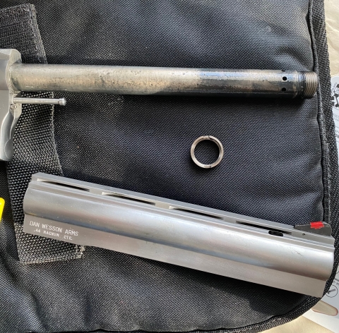

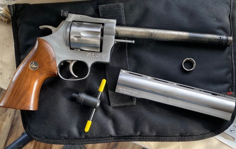

Okay!  I received my wrench/feeler gauge set today.  I have been applying some penetrating oil to it for about the last four days in anticipation of a stuck barrel shroud nut…
To my surprise the nut came right off with little effort!   The shroud came off easily as well.  As you can see from the photos, it’s pretty dirty but should clean up easily( I soaked it pretty well!)
So far, so good!  Have an 8” non ported barrel in the works and think I’ll get the 4” assembly as well.
Thanks guys!
Paul

Photos for above!!  Also, how much should I torque this down past snug when re-assembling?
