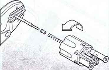

After paying closer attention to the diagram, I threaded the ejector out of the cylinder and I'm working on pulling the bushing and spring now

Forum Posts: 11274
February 15, 2013 - 9:21 am
The spring & bushing won't come off unless you remove the cylinder from the crane...removing the crane involves removing the trigger group, because the crane retainer is under the trigger guard.
So you'll essentially be looking at this by the time you get to that point.laugh
Bk3njfxr.jpgImage Enlarger
It sounds like you probably have it cleaned well enough as it is, for now. It still won't hurt to take it apart for a good scrubbing at some point.
