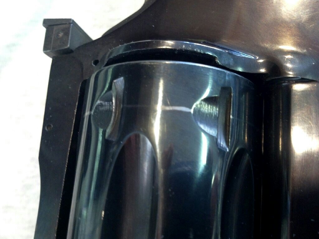

Hey guys,
wondering if anyone can shed some light on an indexing problem with my supermag?  Primer strike is questionable with offset strikes on the primer caps.  Cylinder catch seems a little weak compared to my shooting partners.  notice the marking on the cylinder from the catch, is this normal?  Barrel gap has been set ,  cleaning has bee adminstered.
 Thanks for any help.

The cylinder ring is common on guns that have digested lots of ammo.range-time If you have a fair amount of cylinder movement on full lockup, that can cause off center primer strikes. Off center strikes can be caused by other things too, and are fairly common with revolvers.
I wouldn't worry about it too much unless the gun is shaving/spitting lead, or if you get FTF issues, then you may want to have a smith give it a tuneup.
