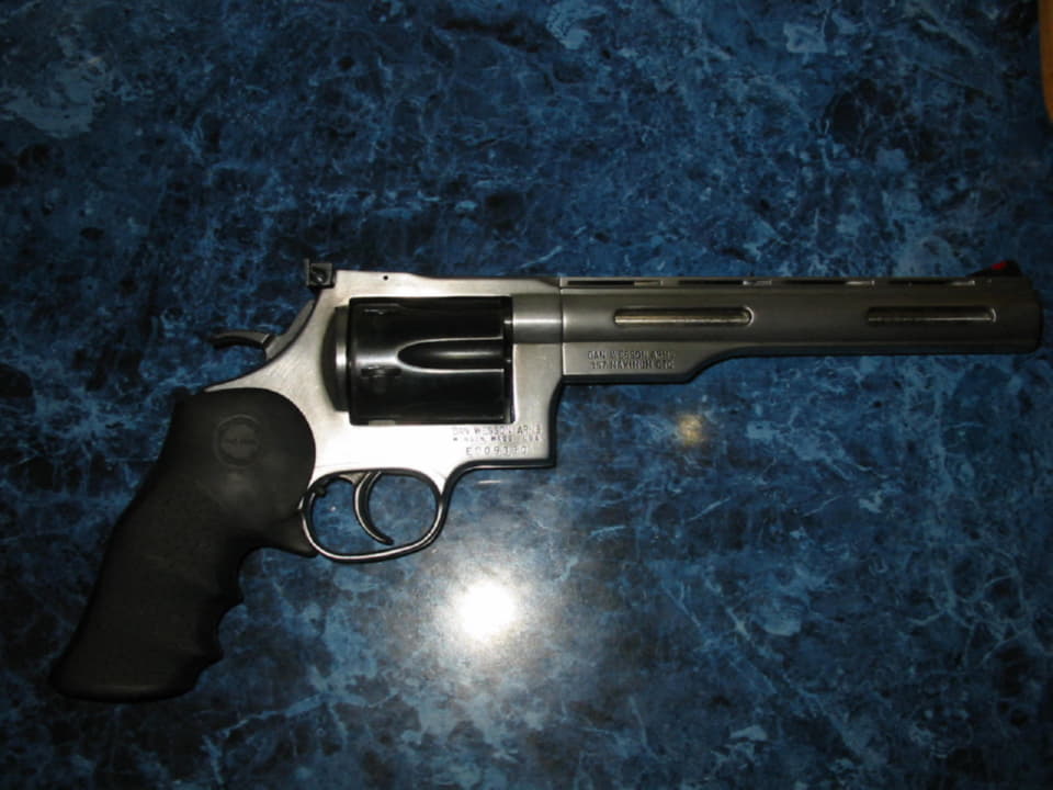

Ok, no crying on the forum. Some of you have seen my 40 and know it's nasty history. As a restoration is impossible, thanks to the previous owner. I have tried a sort of case color on the frame and barrel and it look pretty good with the wood grip. I thinking about going to the gray parkerizing too. Then I came up with this one. Maybe just polish it in the white or in the parkerizing grey. I am looking for a vote of looks good or not. And any other idea's for her. And No Superdan I will not paint it PINK!!!DWF Sign

Another option is Robar's NP3 finish.  It is likely more expensive than Armoloy.
http://www.robarguns.com/np3.htm
I have a very early Kahr K9 with the NP3 finish on it.  The finish has held up perfectly.  The only drawback is the PTFE makes the finish so slippery that it, at times, can be difficult to pull the slide back.  A very firm grasp is required.
-Wayne

Not knowing anything about either of these coating processes, how does the cylinder face, inner frame, and barrel ends hold up with each of these finishes?

I say nickel the gun & blue the barrel.Laugh  BLING!Cool Drool

I have put somewhere around 5000 to 6000 rounds through the Kahr.  Each time after sooting it, I can wipe all the residue off with a dry paper towel.  There has never been any discoloration around the muzzle or ejection port.  But, the finish isn't directly exposed to combustion like on a revolver.   Might be a good question for Robar.

I'm with CF, a nickel SM would be cool!

Now that nickel has been mentioned, I'm with th rest of the nickel supporters.  Nickel would sure make a statement and it's a durable finish.

I have toyed with a nickel SM idea too.  A suggestioon was that the barrel remain blued in a slotted setup.  Good candidate there Max Load!  Someone needs to give it a try!

Nickle would be cool but here is my 2 cents. I do not know the history but it appears to be a stainless gun with a blue cylinder. If so re-blue (if needed) the cylinder and  blue the barrel then polish the gun. This would be a inexpensive option. Just a thought though as I think it looks pretty good from here as is.

I'll vote for polish.

Oh I wish it was a stainless 740. But I am sure I would have never gotten a 740 for the 400.00 I paid for it off of GB in as is condition. We never new how bad it was.
Superdan spent over a month of his spare time to get in the condition it is in today. Frame bent, they cut guides out of the frame for the hammer for a trigger job???Cylinder stop bad, hand cracked and so on. As it has the crowning title of most abused DW we ever seen. It was a purchased from the Los Angles Firing Range. We guessed about a 70,000 to a 100,000 rounds went threw it. A true testament to the strength and durability of one of best revolvers ever made. And still competes in competitions to this day.

The nickel has been talked about a lot. But I get leery as I have owned a nickel SW and suffered with wear issue on the barrel by the crown, And superdans nickel Python as blasted (chipped away) the nickel at end of the of the cylinder from hot loadings. And my love for AA 1680 is a real factor in this too. As her cylinders are fire cut from running 357 magnum. ( Thanks again previous owner). The AA 1680 is the only powder it will run true Supermag loadings without putting a serious ring in the brass, as AA 1680 runs at such low pressures. But at a price as it is a real flame cutter on the frame.

If I would polish and leave it in the white, do you guys think Flitz could hold up?
As the blueing has been removed, and in the white rust is real problem.

Embarassed I did not realise it was in the white, I thought it was stainless. I should have looked closer.

I would not nickel a gun that I was going to shoot a lot. Np3 is pretty durable, and if you wanted a two-tone look you could:
Re-blue frame, shroud, crane
Np3 barrel, cylinder, cylinder latch, trigger, hammer
I think the look of Np3 showing through the slots, backed by the cylinder and 3 other pieces contrasting with a brand new shiny blueing would look HOT
