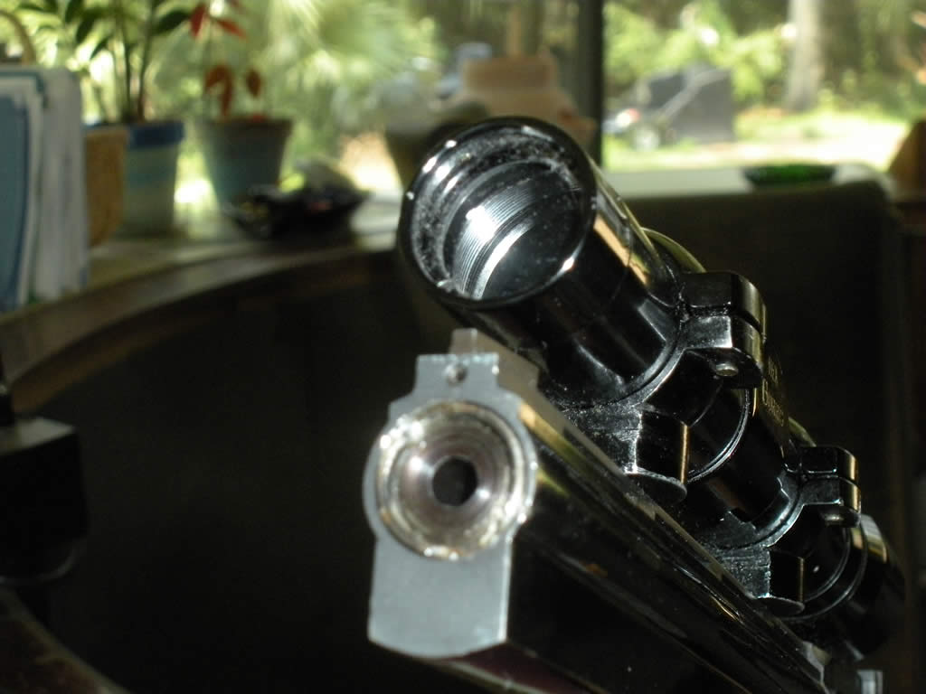

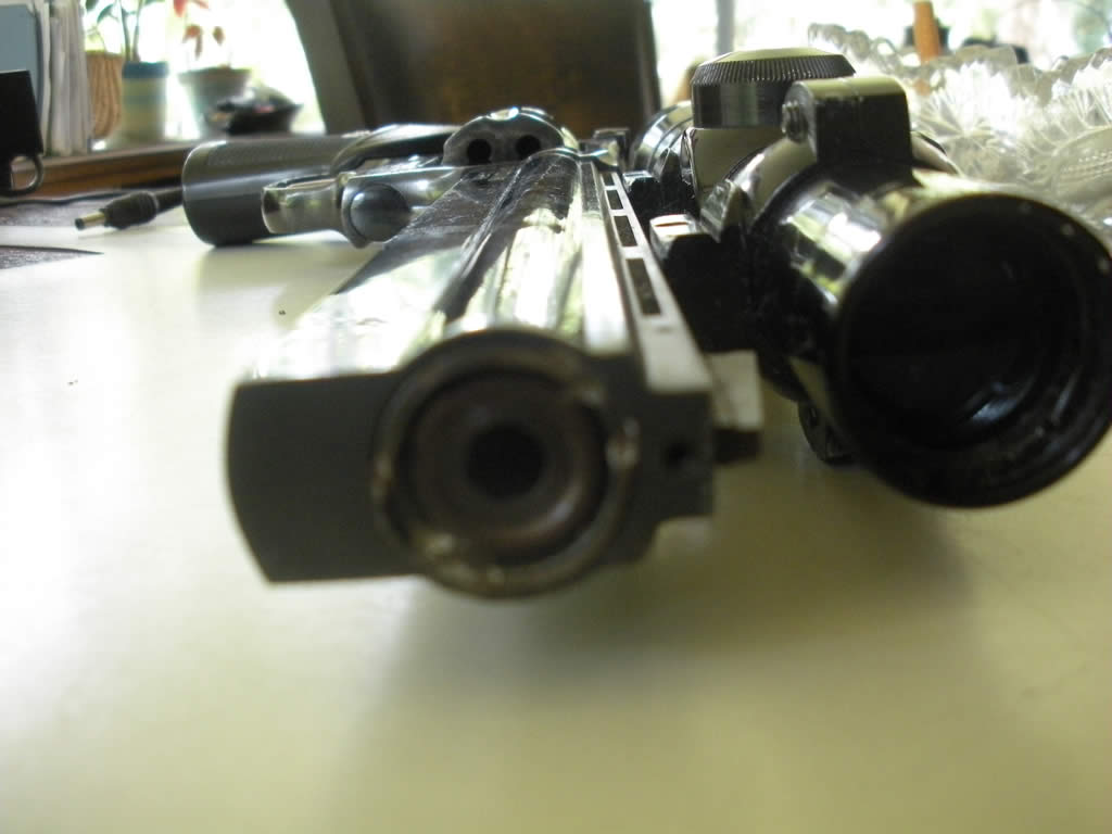

I do have a pre attempt pic that I can get on here in a while. I am almost , or ok I am embarrassed to show you what it looks like after the impact driver debacle..

Where  a healthy barrel nut has a nice defined 90 deg. notch, mine came with the left side eroded into a 45 or 30 deg angle up to the top of the nut. When I try to unscrew the nut, the incline just pushes the barrel wrench up and out of the notch.
I use an impact driver every day in my line of work and I don't know how we ever did without  before. That is what further served to mangle the rest of the nut ... As my Dad would have said for sure, who is what or is that nutt or nut,

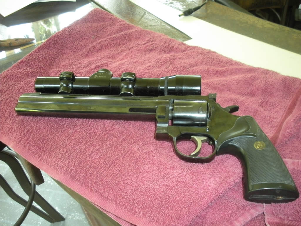

The pics:

Hey Harley,
OK, thanks, I really did a number on it with the impact driver and there's a semblance of what a trained eye might call notches. I am going to proceed with caution from here on out.
From what I can tell about the threaded rod method, the forcing cone end of the barrel should rotate after I get enough tension on the end nut. I am temped to consider a split washer on the frame end to help it grab hold of the barrel but I am doing my best to not just dig my hole deeper here, so members, please advise. For the time being I am letting the Dan and I have a little time out session before I try any more homesmithingembarassed
Jeff
