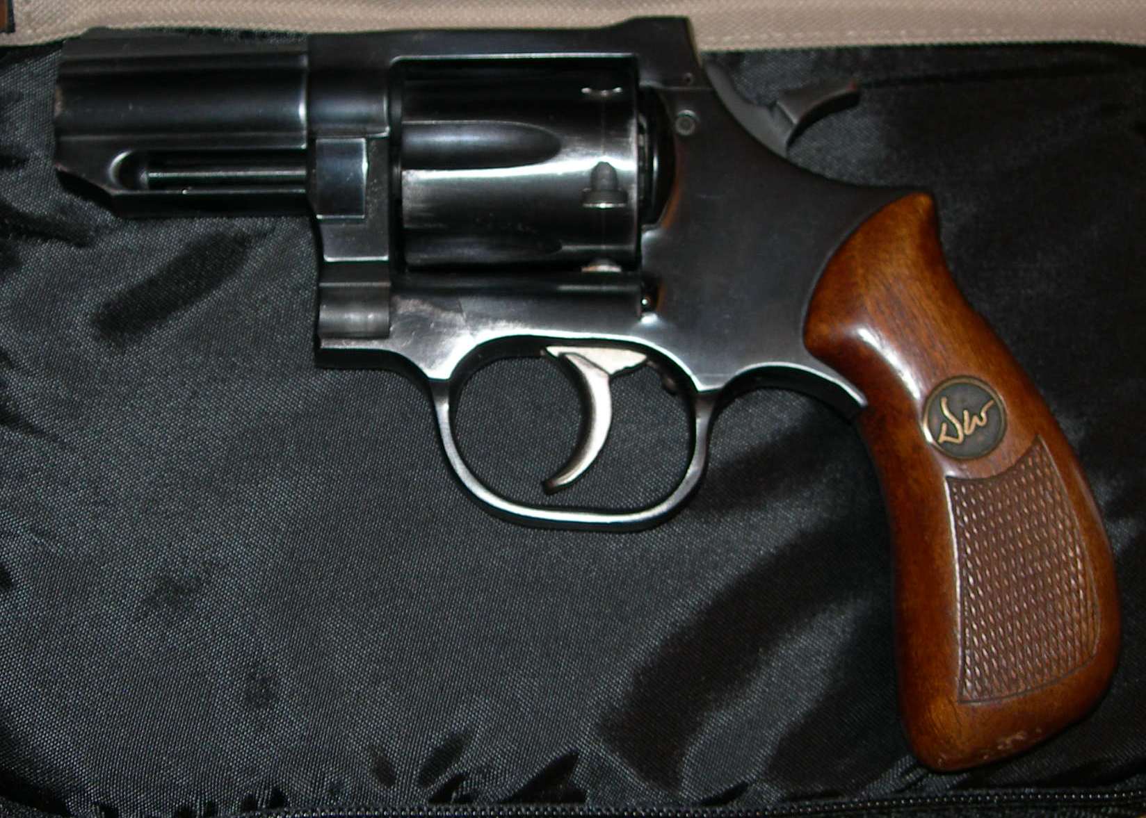

I got a Wesson Firearms, Palmer Mass, 2 1/2" fixed barrel 357 Magnum a couple weeks ago in a pawnshop.  It's a heavy little beast, weighing 28 or 29 oz.  Clearances are good, cylinder is tight with 6 good alignments, all the good things.  There is even an over travel screw...  slick!
I tho't I was getting a Dan Wesson revolver, after-all it has wood grips with the "DW" logo...  And then I researched it after I got home, and found all-sorts of horror stories about the Palmer manufacturing plant.  I gather this can't be properly called a Dan Wesson revolver (Someone correct me if I'm wrong).
I took it to a local range and fired it.  Single action is a dream; double action is short and clean, but heavy.  I fired everything (38 spcl) I had in-hand: 125 gr+P, SJHP, 130 gr FMJ Remington & Winchester, and 158 gr SJHP (the most accurate load in Ruger LCR).  I am encouraged that it fired everything with no variation in elevation (unlike the light-weight gun).  But it shoots 3" left at 7 yards.  Then I looked at the frame more closely, and found the rear sight groove is machined significantly (nearly 1/16")to the left of center.
Unless someone tells me a better way, I plan to adjust the rear sight with a file, and maybe 30 minutes range time.
The remaining issue may be with the hand spring.  I read these bend and make the revolver unreliable in DA.  Any advice here?
Recapping:
1.  Is this a Dan Wesson, or a "pretender"?
2.  Is a file the best way to laterally adjust the sight?
3.  How bad is the issue with the hand spring?
Thanx bunches,
Fountain

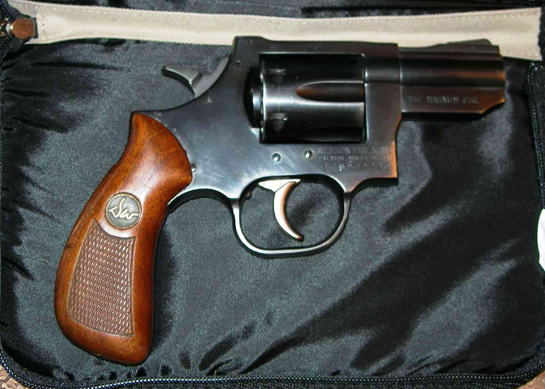

Thanx to all...
Am trying to post a few hurried pix.  This is a learning experience, but maybe it'll do.  Suggestions/instructions on the process?

Definately a Dan Wesson
Never heard of hand spring issues
3" in 7 yards is pretty darn horrible.. my first thought is to remove the barrel shroud and make sure the index pin is there and that the shroud is being fit correctly into it.
ACK went back and read "fixed barrel" .. so scratch the remove the shroud idea. I still am not big on messing with the frame. My next move would be to look at sight blade.

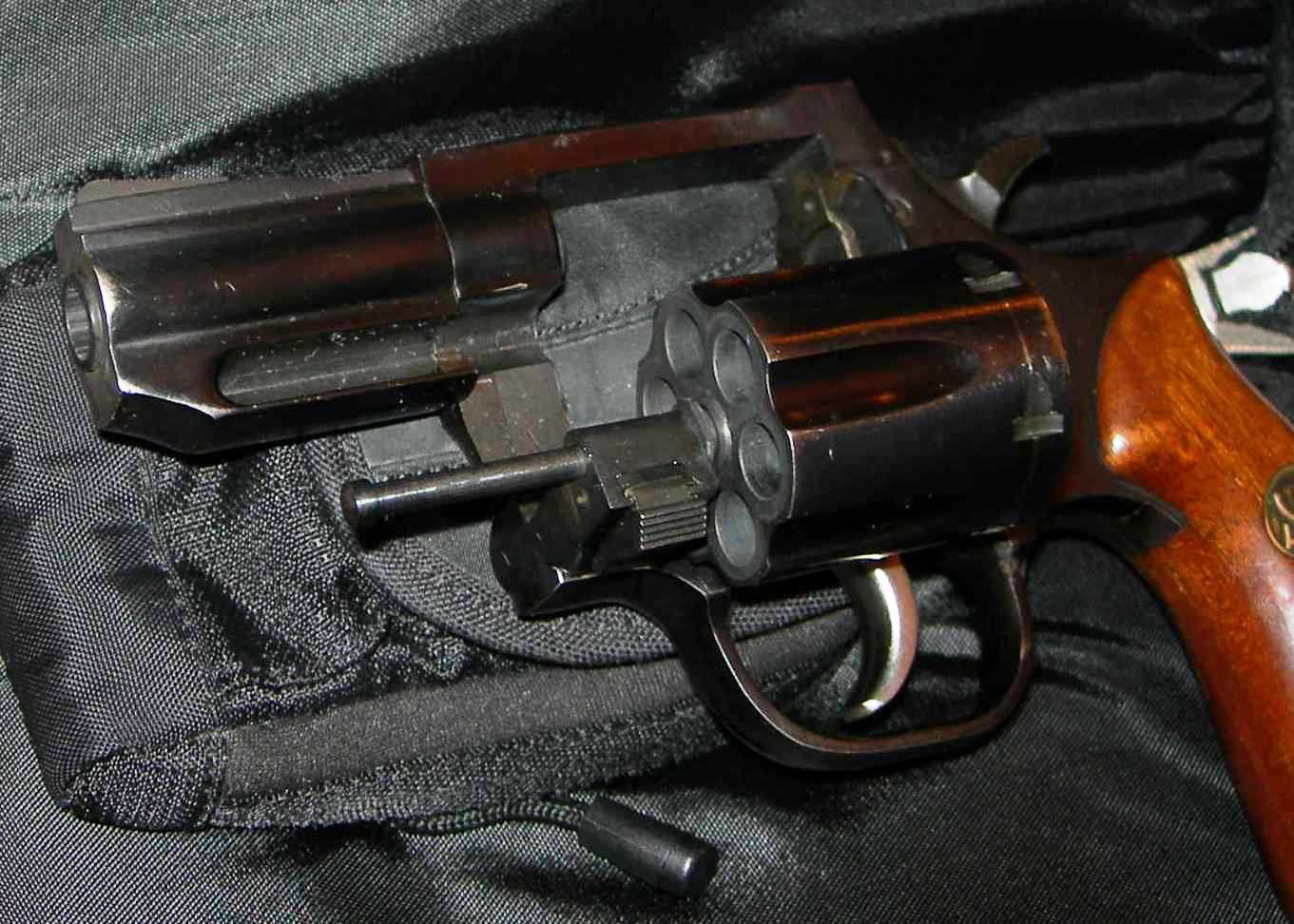

This is a fixed-barrel gun; does it have a barrel shroud?  Did you note the machining on the rear-sight groove?
I think this is what I have, quoting from my research, "Model 14 Fixed Barrel   - .357 Mag. cal., 2 1/2 or 4 in. (fixed sight Service Model) barrel, satin blue finish. Mfg. 1993-95."

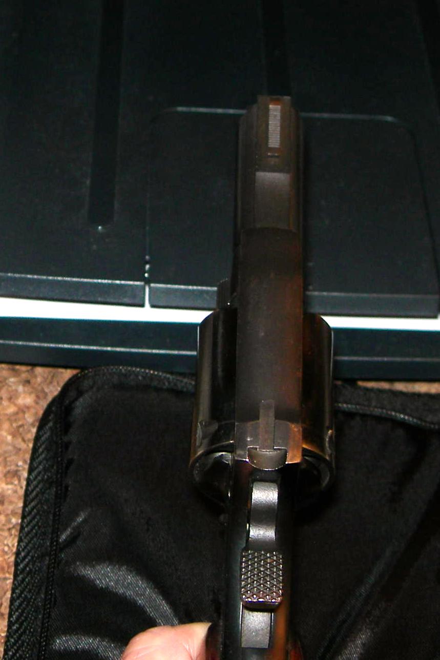

I looked at the front sight first.  It has a single pin entering from the right side.  According to my calcs, with a 4" sight radius, I'd have to remove 0.048" from the right side of the front sight (0.095" from the rear sight groove).  Did I calculate that correctly?
My thinking is that the rear sight groove is so badly placed that a little work at the range would be easier than trying to work on the front sight.
Will appreciate any insight you have on this.

Was asked on the "New Member Forum" if I was sure it was a "fixed" bbl.  As I study the gun, I'm not sure.  The more I learn, the less I know.  Here are the pix I posted there, what do you think?
And if it's not a fixed-barrel, I need even more help...

In your first pic, I can see the rear sight is machined to the left. The proper fix for that would be to send it to DW & have them weld it & cut it straight...but that may involve more money than you're willing to spend.
Another option would be to have a smith cut the top of the frame for an adjustable sight & turn it into a "model 15". I've seen that done to some guns on GB & it rarely looks good, though.
Hmmm...I wonder if EWK could make you a new front sight that is "Z" shaped?Laugh That would be a relatively painless fix.

Do you think DW would be willing to deal with the rear sight.  I don't know about welding, but widening to the right would be good.
