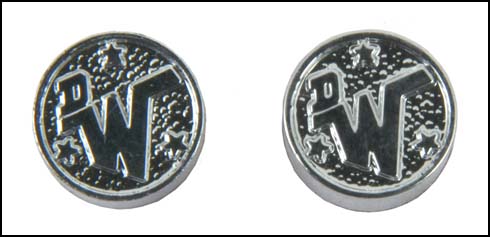

I may be a little off on my date range but I believe around 1975-1976 they switched from the pinned front sight like you have to the changeable sight that are most common.  As for the grips they are made out of PowerWood (Plastic).  This was something they were trying out back then.  The ones I've seen are pretty hard to tell they are not some type of hardwood.
Did the medallions like the ones above?

The medalion is simiilar but maybe smaller with no D just a W that looks look the one in your pic.

What do your medalions look like?
January 1, 2010 - 10:24 pm
I have an odd medallion also--my grips are wood, but the checkering is pressed instead of cut, and the DW medallion is silver instead of brass/gold.  My seller swore he was the original owner of my pack also, and said he only put half a box of ammo through it.  I find it hard to believe it came with both 14 and 15 barrels, but who knows.

The Powerwood grips with small medallions, should mean that the Pistol Pac is probably a 1976 manufacture.  That's only my guess.Wink

2 Powerwood grips - one with small silver medalion with a W

I'm going to add grip medallions to the history thread, so if you get bored.... Set the camera on macro and get us a close-up of that medallion πŸ™‚  You can also shoot a front sight pic...

The grip with the medallion is pretty much what I had pictured. Although, this is the first time I've seen one of those medallions up this close. Very interesting.
